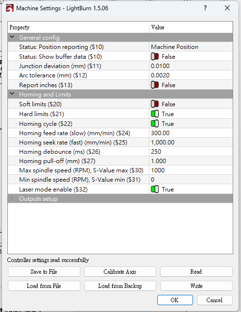

Hello everyone, recently I purchased the Tyvok Spinder A1 and intended to use it as a graduation gift for my friend. However, I am encountering a recurring ‘Error: 9’ problem. Despite exploring the platform and discussions, I haven’t been able to find a solution. Therefore, I am reaching out here to seek your assistance. Thank you.
Here is the console and my device settings:

[MSG:Using machine:MKS DLC32]
ok
[MSG:No Wifi]
ok
ALARM:8
Homing fail. Cycle failed to clear limit switch when pulling off. Try increasing pull-off setting or check wiring.

ALARM:1
Hard limit triggered. Machine position is likely lost due to sudden and immediate halt. Re-homing is highly recommended.
On or near line 0:
Job halted
Stream completed in 1:13
error:9
G-code locked out during alarm or jog state.
error:9

Starting stream
Layer C00
Grbl 1.1h [‘$’ for help]
ALARM:1
On or near line 0:
Job halted
Stream completed in 0:38
error:9
error:9
