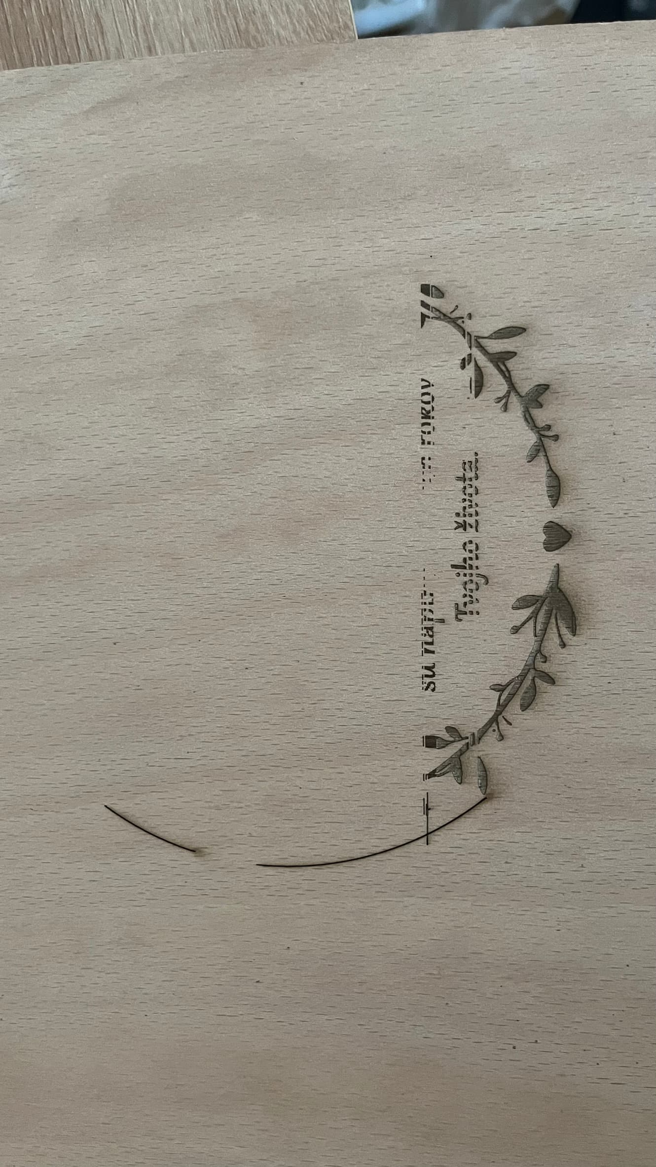

i would like to make graphic in lightburn and save gcode to usb, then load into uccnc and run engraving. i don´t want to drive it directly from lightburn. But it´s not working correctly with xt-8, i still have missing lines or added lines. (on plh3d-30w it works for vectors fine). therefore i am asking if you are able to work with exported gcode in uccnc correctly, and if yes, what is your setup.

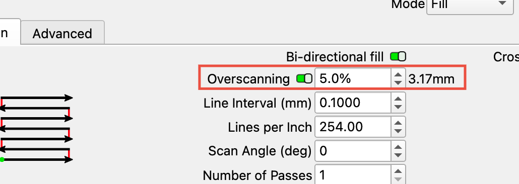

Are you not able to adjust overscanning? Does changing this value not affect the outcome at all?:

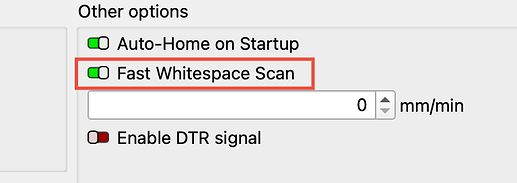

What happens if you enable overscanning and 'Fast Whitespace Scan"?;
Hi, overscanning i have usually 6 or 8 %. here is picture what is wrong. it´s happening for each graphic. Missing lines, added lines which should be no there, missed graphic in the middle.
i never tried fast whirespace scan, i will try tomorrow.

Missing lines I can see. Lines that should not be there I cannot verify because there is no straight edge in the image for reference. You did not mark the image to indicate which lines should not be there.
I downloaded your file and see the orientation of your picture is rotated 90 degrees from that in the Lightburn file. This introduces the question of which axis has the missing lines. We cannot assume it is the Yaxis for sure.
I examined your Lightburn file and did not see anything that would cause what you show in the picture. However, the burn in the picture is the last layer in the Cuts window, and your output is set to OFF. This indicates this is not the exact file used to produce the picture because one or more changes have been made in it. The effect of those changes is unknown.
