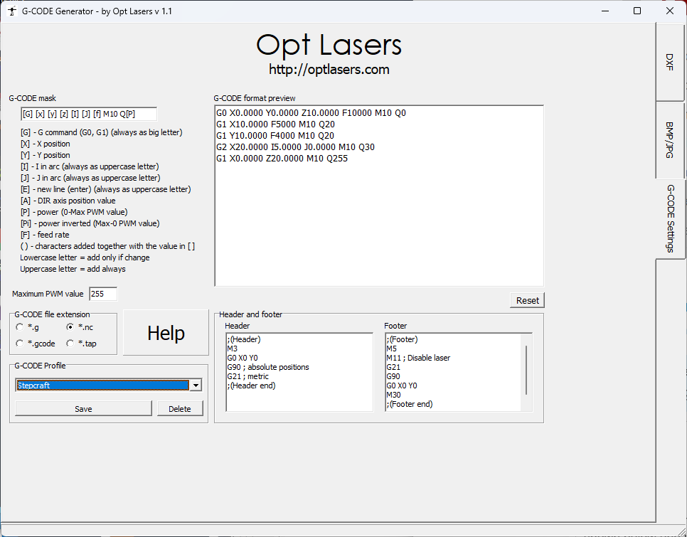

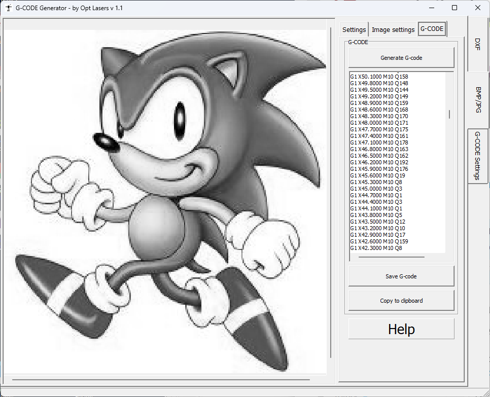

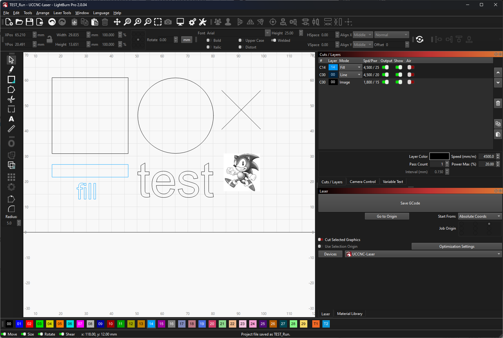

When using the G-Code Generator by Opt Lasers are you getting better results?
I have attached the gcode from the example shown below using the ‘Stepcraft’ G-Code profile : GCodeOPT.nc (716.4 KB)
Here is a Custom GCode ‘UCCNC-Laser’ device that should produce GCode very similar to the G-Code Generator by Opt Lasers as above: UCCNC3.lbzip (2.1 KB)
Do you have issues with any of the layers in this test file?:
TEST_Run.lbrn2 (66.3 KB)

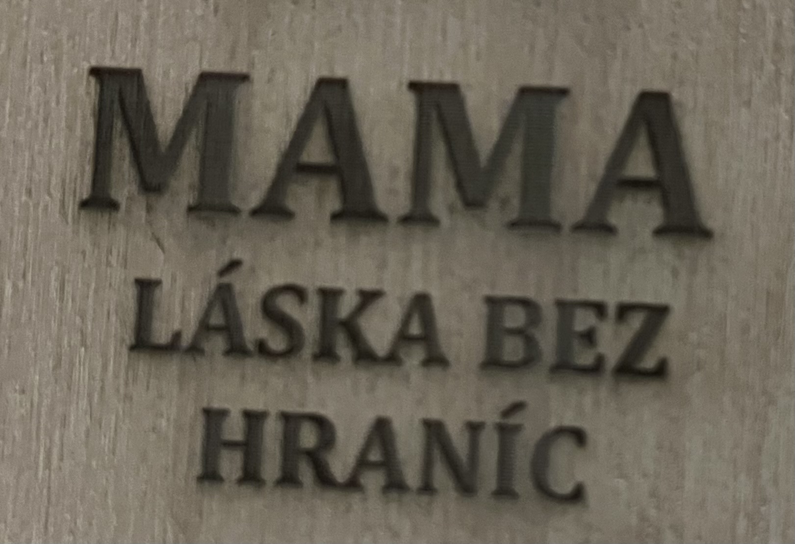

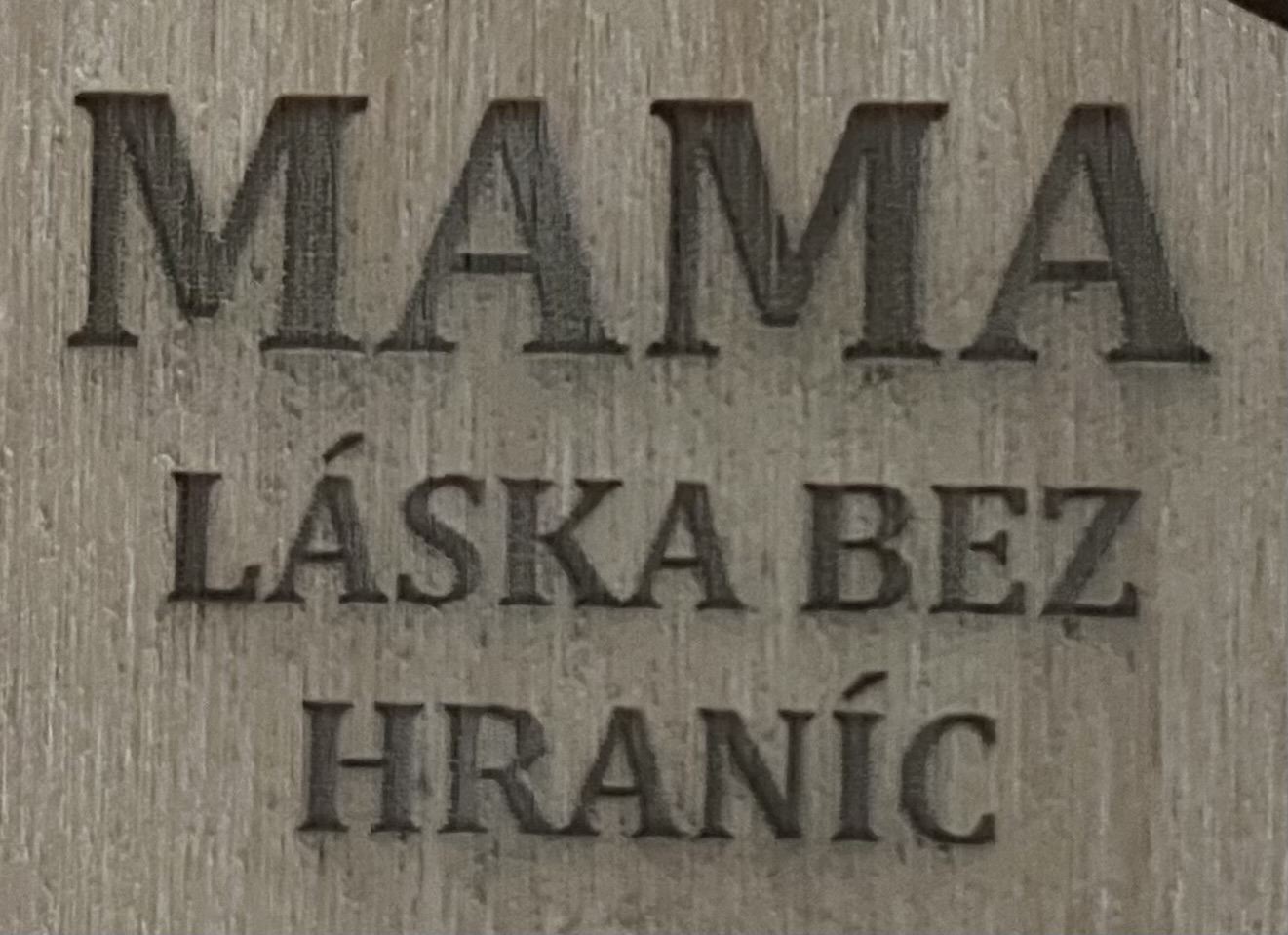

i´ve tested your profile and exact file.
i just improve pwr for laser for picture, because it was overburn, results is now with 3% PWR.
I think pictures never will work for that. i will need to use uccnc picture egraving module.
but it should be fine to work correctly for vector graphic at least.

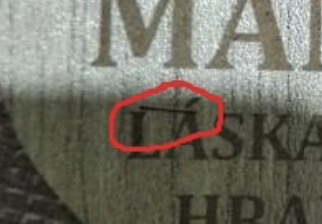

Now it´s still not working properly.

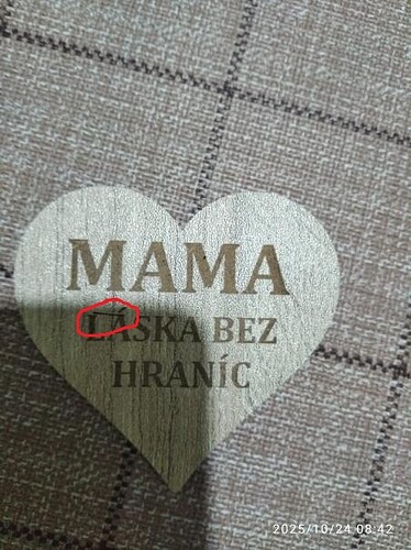

i am attaching also my file and g-code for my graphic - heart
mama_laska_bez_hranic.lbrn2 (77,4 KB)
mama_laska_bez_hranic.gc (56,4 KB)
, where during movement to another letter it´s doing engraving line which should be no there. it´s happen randomly for me for different graphics, once it´s there, once not.

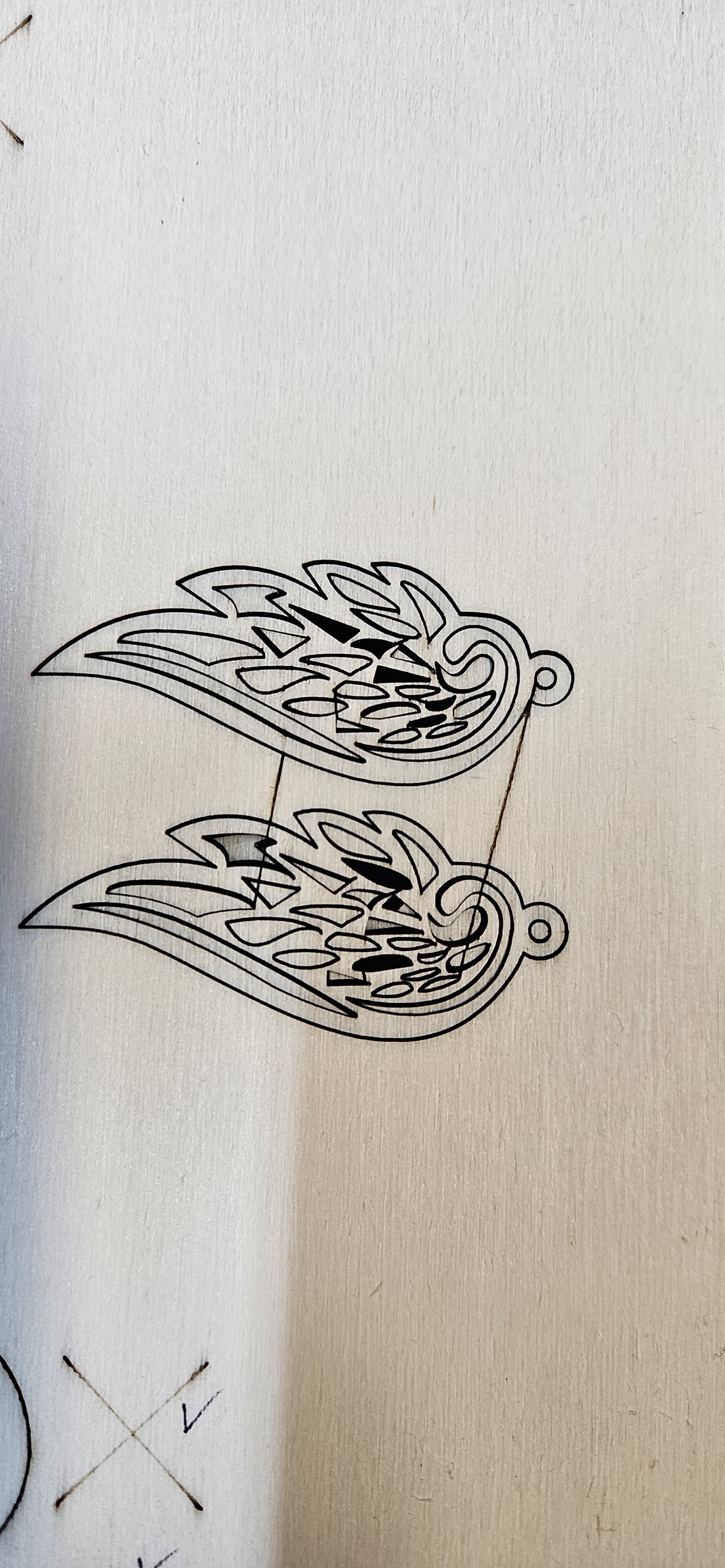

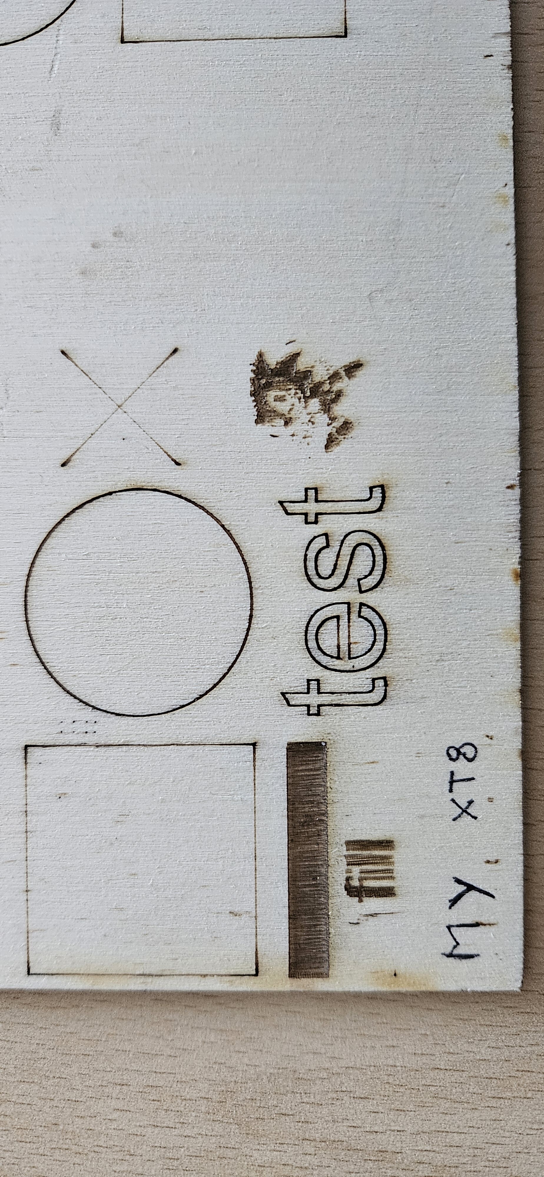

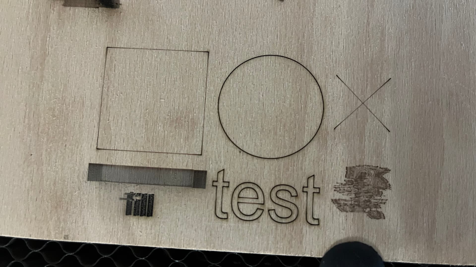

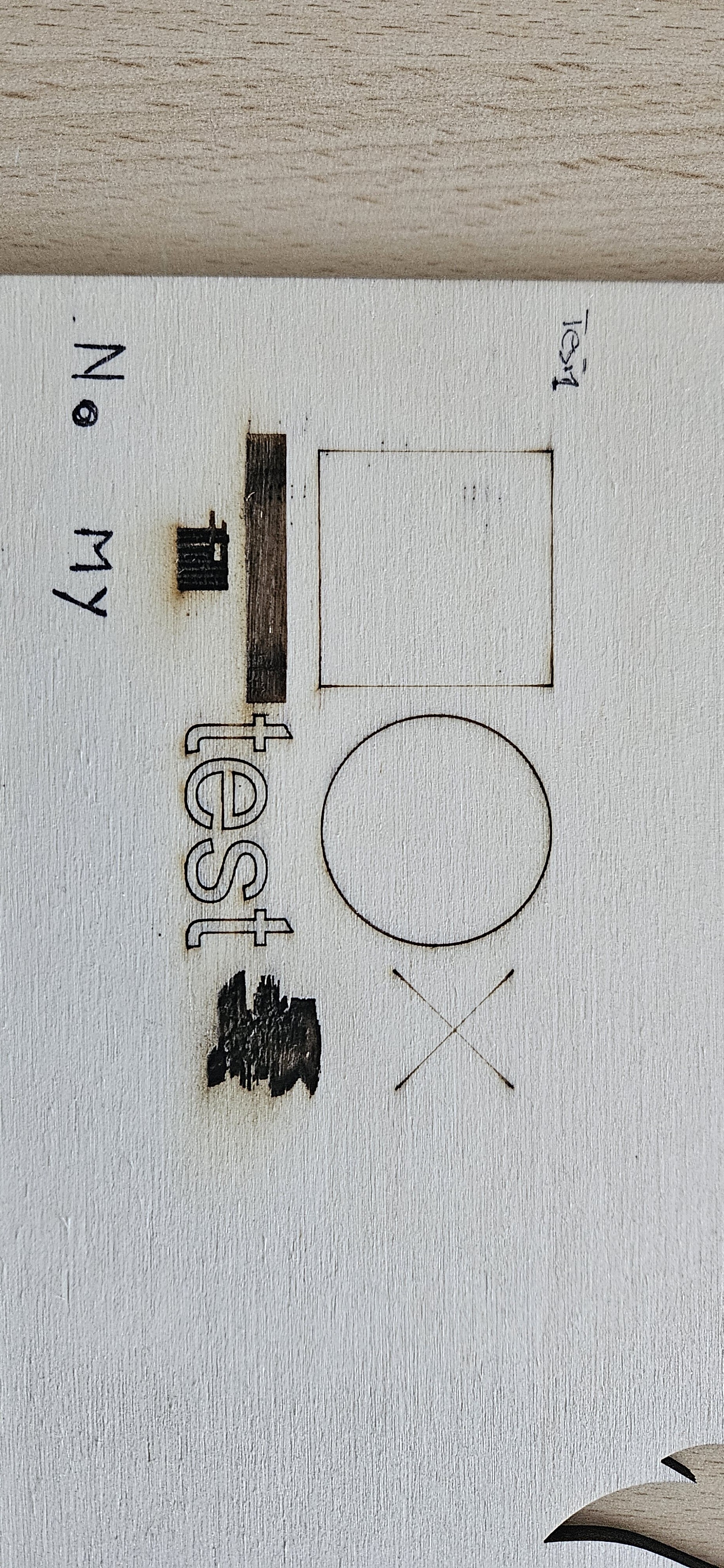

I tested the profile too…disappointing results.

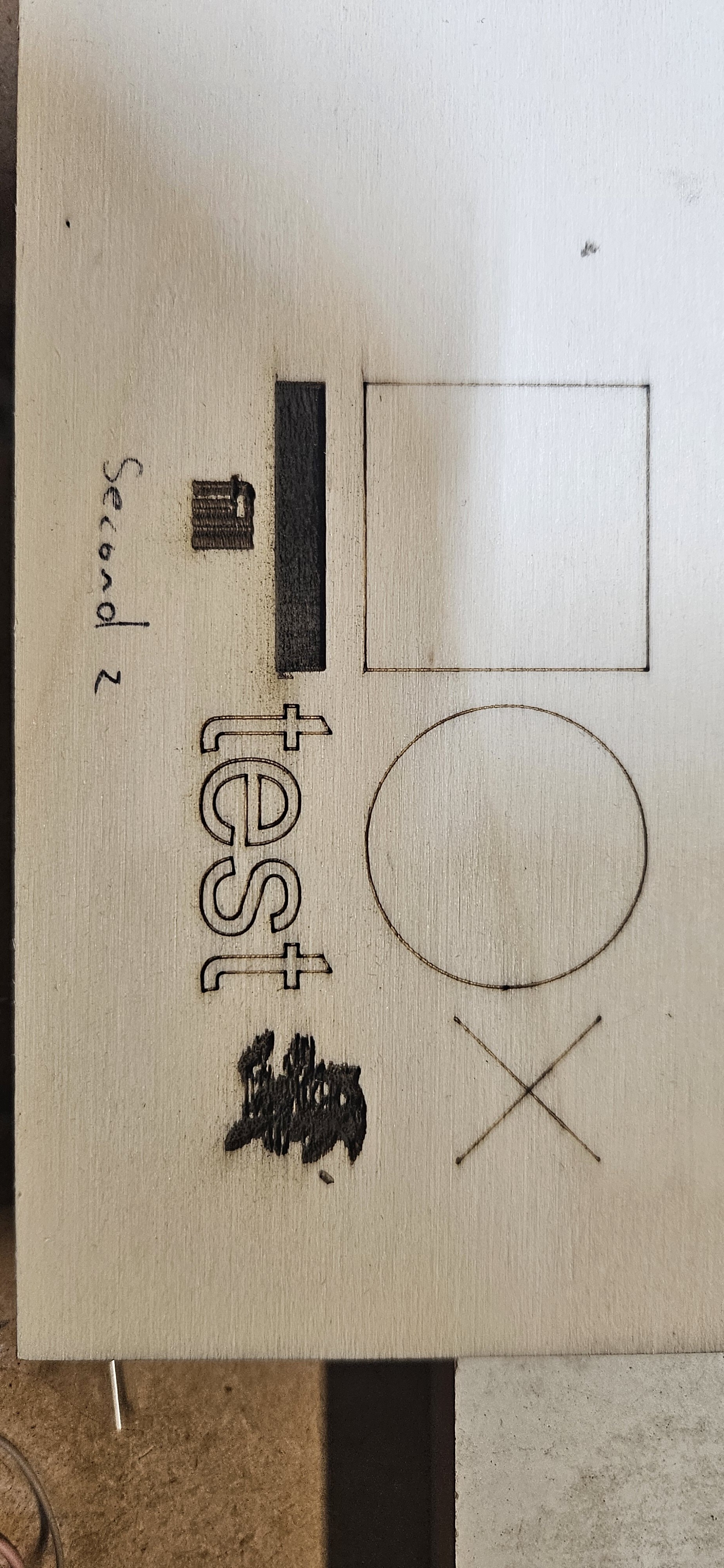

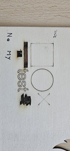

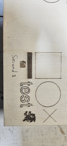

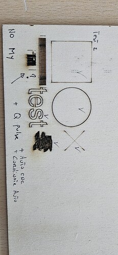

I put together the images and I’m here.
The first two images are from the recommended test using the UCCNC3 profile (not My) while the next one is the same test but with my TX8 settings.

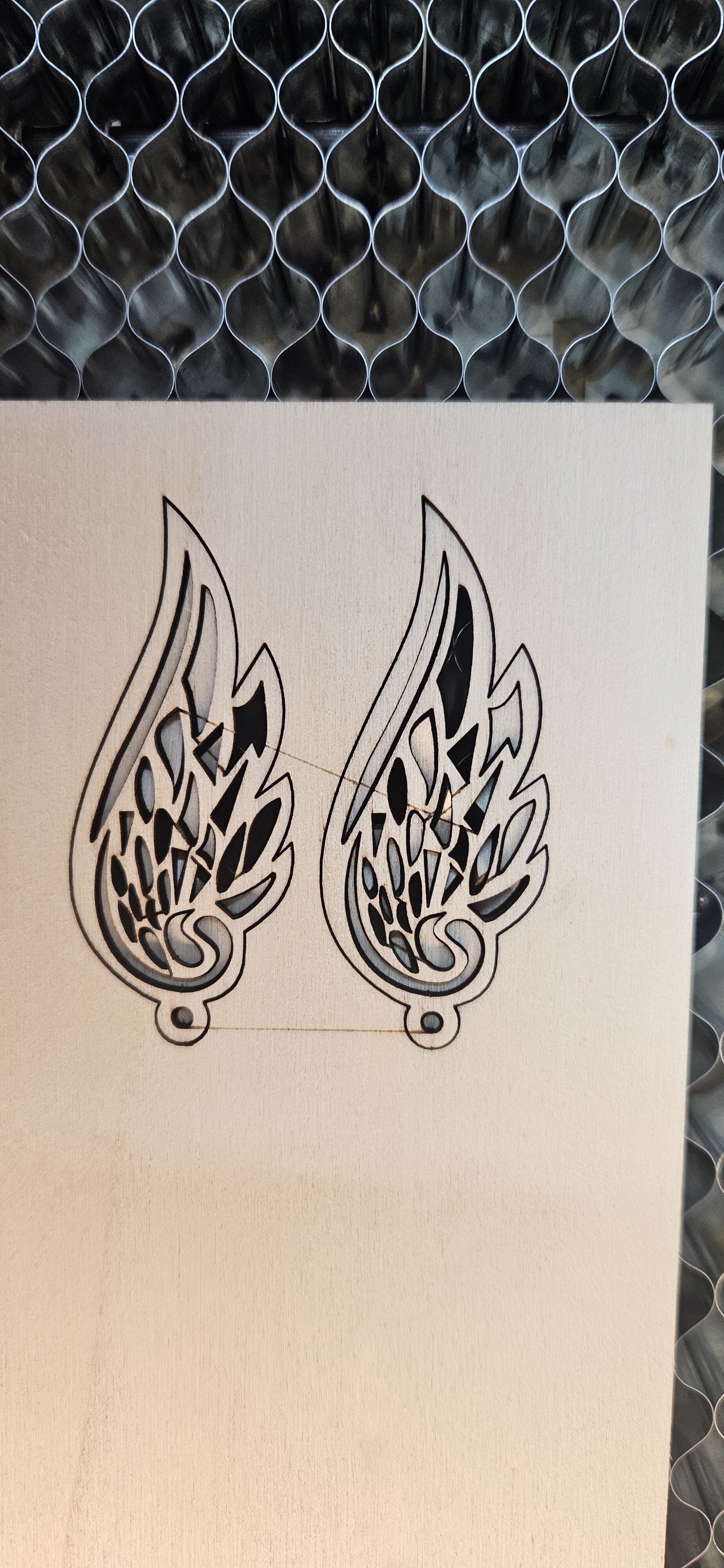

I can see by checking your GCode (tmama_laska_bez_hranic.gc) that this is not due to LightBurn, as this is a ‘M10 Q0’ travel movement’, but your controller seems to not always be able to execute the instruction to change the PWM spindle power fast enough?
If you halve the speed (and the power) are the results better?
Then I tried to see the configuration (without touching the g-code) Setting that mine is a cnc and using the PULSE Q.
I redid the (not my) test and the lines are highlighted so it gets worse…
My setup seems to work better, but unfortunately I can’t resolve these connection lines, which are sometimes there, sometimes not…
Since I’m working in Lightburn, it’s the one that writes the gcode…
The XT8 settings look better, it hasn’t burnt the overscanning area, can you attach the GCode for that please so I can check it.
Try using the ‘UCCNC-Laser’ profile but greatly lower the laser speed and power when burning images and turning off overscanning in the layer settings might help also.

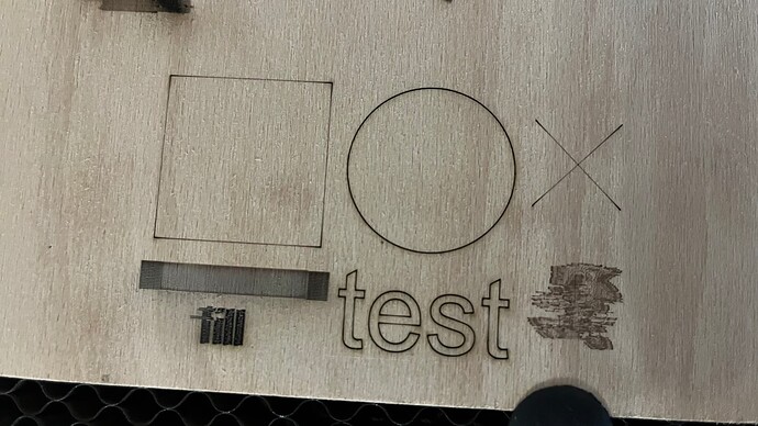

Using UCCNC_LASER and following your advice to reduce speed and power:
Halved by half_bad result
2 image tests 600 6%
line 2000 10%
Fill 1000 15%
improved
improved
3 test
image 600 2%
line 1600 10%
filling 1000 5%
I don’t deny the improvement, but unfortunately the earrings still have the same problem even using lower speeds and powers and UCCNC_LASER.
I attach my axt8 configuration
AXT8.lbzip (4,8 KB)
TEST_Run_AXT8my.gc (78,6 KB) this is the gcode instead…
Reading the various codes, perhaps I should configure it so that the fast movement “G0” is written like this: “G0x0y0z15M10Q0” and not as I have it now: “M11 G0X0Y0z15”.
Thus avoiding turning the power on and off, so to speak.
i tried your profile XT-8.
Same line on my graphic between movement.
i setup lower spd from 4500/min, to 1000/min and pwr from 30 to 8.
it helped. see picture
Then i tried move back to speed 4500/min, pwr 30, but i increased overscanning from 6% to 10%.
and it worked for this graphic - see picture.
i will try more pictures if everything is working correctly for vector graphic.
