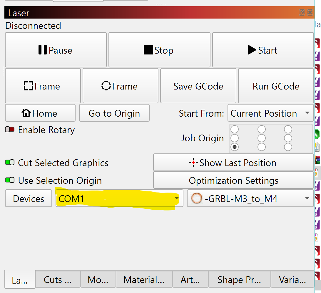

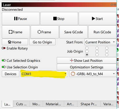

Close other applications and make sure LightBurn has exclusive access to the COM port then select here the correct port:
The Doc:
And start here:

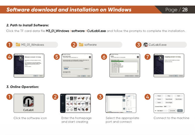

Your laser manufacturer claims compatibility with LightBurn, but I don’t see any instructions provided on their website. https://blazexlaser.com/

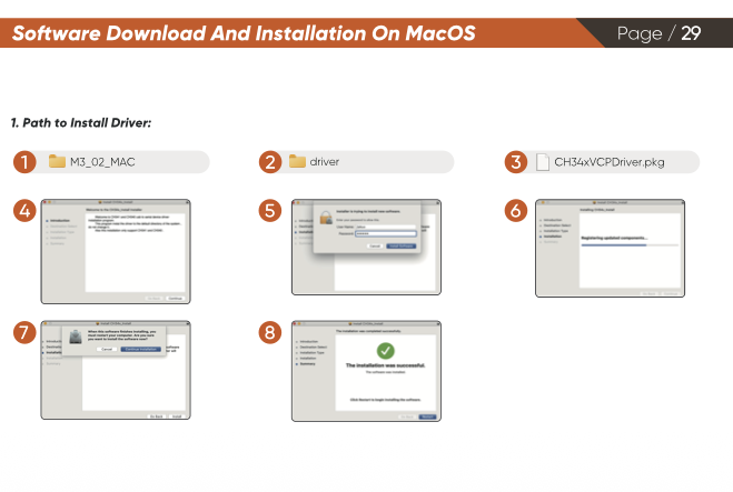

In the manual, I do see a CH34xVCP driver mentioned
Did you install the driver? In your windows device manager, is the your computer recognizing the machine is connected and assigning the laser a COM port?
