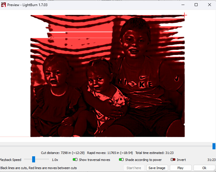

Please show us your preview screenshot. Enable “show traversal moves”
Check your OVERSCAN setting
Hi Jim! Thanks for your reply! Once I turned on “show traversal moves" I immediately saw the issue. When I researched what overscan is, I got it figured out… for one pass! Had it going, but speed was too fast and power too low so it didn’t burn anything (after adjusting the overscan value). So I stopped the job, increased power, reduced speed (from 17000 to 3200), and now it’s doing it again! I turned off overscan but that didn’t help a bit! This thing was working perfectly until the upgrade and burning a test grid on a couple of different media.

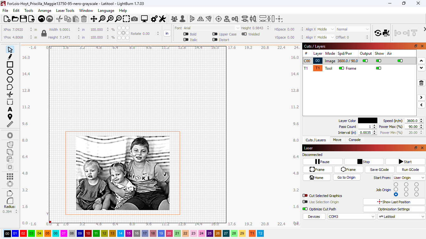

Here’s the work area with the Cuts/Layers window too:
Details from the Layer:
And the preview:

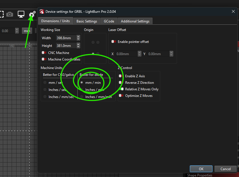

You have spec set at 3600 hours in/min. That is not a valid speed for your laser. Change the units to mm/min and then try 3600
That’s interesting! How does that get changed from mm to in? And how do I change it back?
Sometimes hinges change when updating.
It’s in the device settings menu
These get bumped sometimes during updates and bug fixes. I find it helpful to review these settings occasionally as a general exercise.
Thanks to you both! I have reset those settings and am now back up and running! Really appreciate the i sight and advice!
