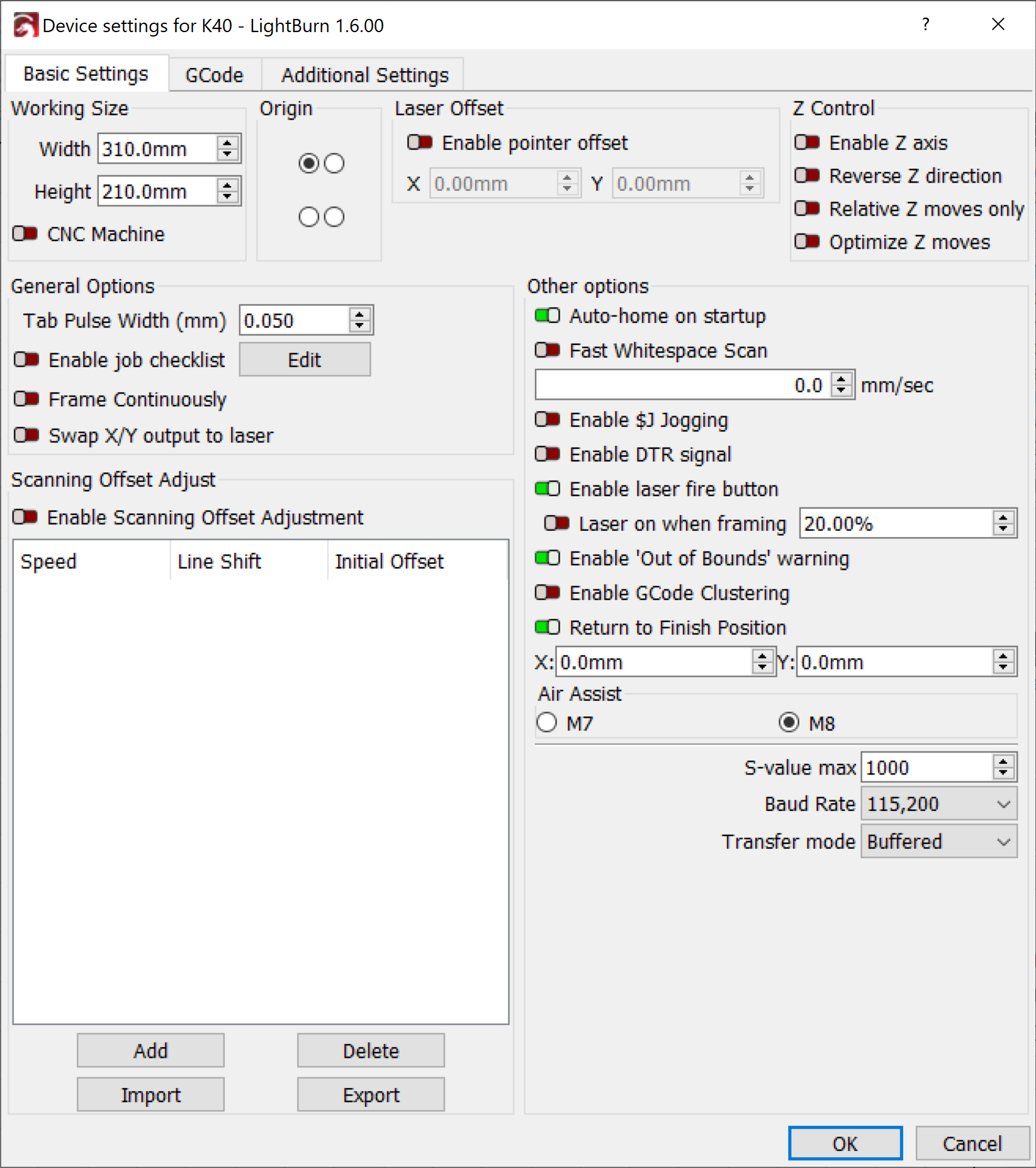

Hi,
New Lightburn user after upgrading the controller board in my K40 to a Monport GRBL V2 Controller.
Having problems setting the correct bed working size. When I first added the device I just left the default width=300mm and height=200mm setting, but that’s not quite big enough for my bed.
So I went into Device Settings and changed the working size to width=310mm and height=210mm - probably not accurate and needs to be bigger, but was starting with small increments to work out the correct values.
However when I use the move window and move anywhere over 300mm on the X axis or 200mm on the Y axis I get an ALARM:2 error message as follows:

Here is a screenshot of my Device Settings:
Thanks for any advice.

Keep your workarea (310x210) in Lightburn type in console $130=310 enter and $131=210 enter, but do some tests first, because the speed of laser engraving/cutting is usually higher than jogging in the move window.
Perfect - thanks for your help.
Actually was just twigging after seeing the 300 and 200 max limits in the $$ command you got me to run that changing Device settings hadn’t changed the firmware settings, so it seems Device Settings is for the work area shown in lightburn and have to also change it in Machine Settings or via the console.
Thanks for the clues and taking pity on a Lightburn newbie.
