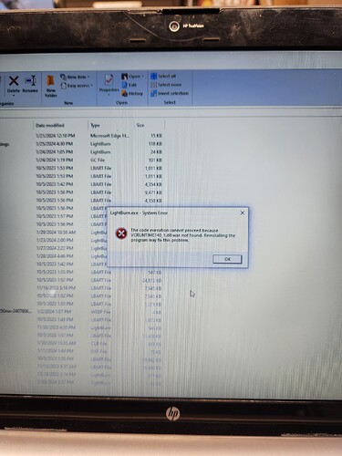

I am running a Roly 20 watt. Yesterday I tried to install the 1.05.01 update. Prior to updating, a window appeared that looked like a Microsoft Software License Terms, Microsoft Visual C ++. Thinking that it was something new that Lightburn was doing, I clicked install. After a minute or so and nothing was happening, I closed it and the Lightburn installation window appeared. After installing the update, I kept getting a couple of popups stating, “Windows cannot find ‘C:\Program Files\Lightburn\unins000.exec’.” and another stating something about it could recognize another file name.
Now I am unable to open Lightburn at all. I need to get it repaired to fulfill a couple of contracts the I am committed to.

These are the popups that appeared when I tried to open Lightburn.
Install the C++ runtime and reinstall LightBurn.

I cannot thank you enough for your assistance. The system is back to normal.
