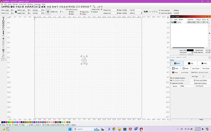

I am using an Xtool D1. I just updated the Lightburn software and am unable to access Absolute Coordinates from the menu. I was following the tutorial on Xtool for making a template. I tried with 2 different computers and still couldn’t get Absolute coordinates select. Any help would be appreciated. Thanks

![Screenshot 2024-06-08 204420|690x431]X-tool D1, GRBL, Updated Lightburn today. Thank you

Your Lightburn is already in Absolute Coordinates.
And your refence point is the middle of your shapeimage
It is showing absolute but it is grayed out and not accessible. When I go to Current or User the circle shows up blue.
The second image just showed that my Xtool was chosen and the GRBL
It´s grayed out because the reference X0 Y0 is your laser home position.
