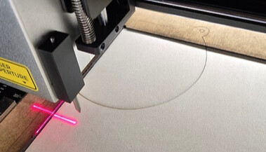

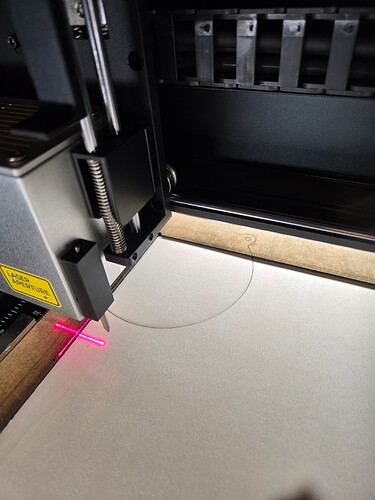

On my XTool s1, I have placed the honeycomb in various places of the laser bed and found that what has worked best for me, is the back right side. Even in this case the laser module won’t reach the entire bed. I use a spacer to place my boards in the right place every time. The boards are framed exactly where I want them, however when cutting, it cuts off about 5 mm from where it should. (I believe this is because the laser module is hitting the front.) Is there a better place to place the honeycomb, so I can use the entire bed? It’s advertised to be able to cut approx 24x15, but I can’t even get it to cut a 12in board correctly.

OK. I understand what you are saying and I really appreciate your responses. Do you have any suggestions as to why it’s not cutting what is framed, even though I believe the kerf is set correctly. I’m not getting much help from XTool customer support
You could have a pointer offset enabled ?
What is your start from position? Are you certain you’re using the correct “start from” and aligned correctly to your materials?
I did have pointer offset enabled, and I thought I had it set up correctly. I’ll redo it based on your recommendation.
I usually use the start from current position, and adjust accordingly depending on where my work is on the laser bed. I always frame my work and make sure it is exactly where I want it.
I’ll redo my pointer offset and see if that helps.

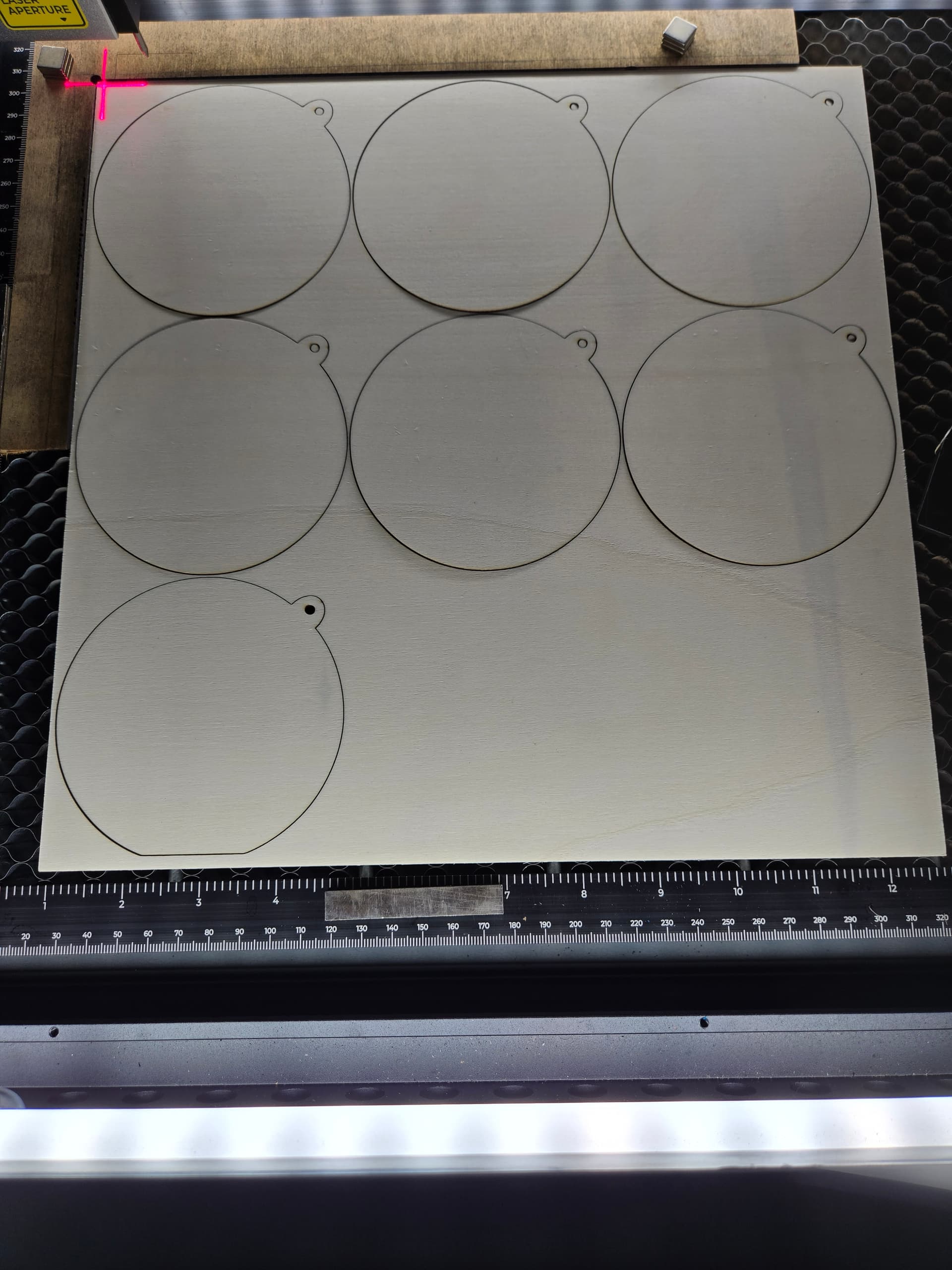

Well, my laser offset was way off, and after resetting it, I got the same result. Again, the laser framed perfectly on the board, but still cut off the bottom of the circle on the last row.
retrying cut file
Had to reset in new file. started job at current position and it went way off the top of the board. changed start position to user origin and cut in same place as the first time
printer offset result is in the picture
Well there you go, it does look like it cuts to the top that’s probably where your lost area is

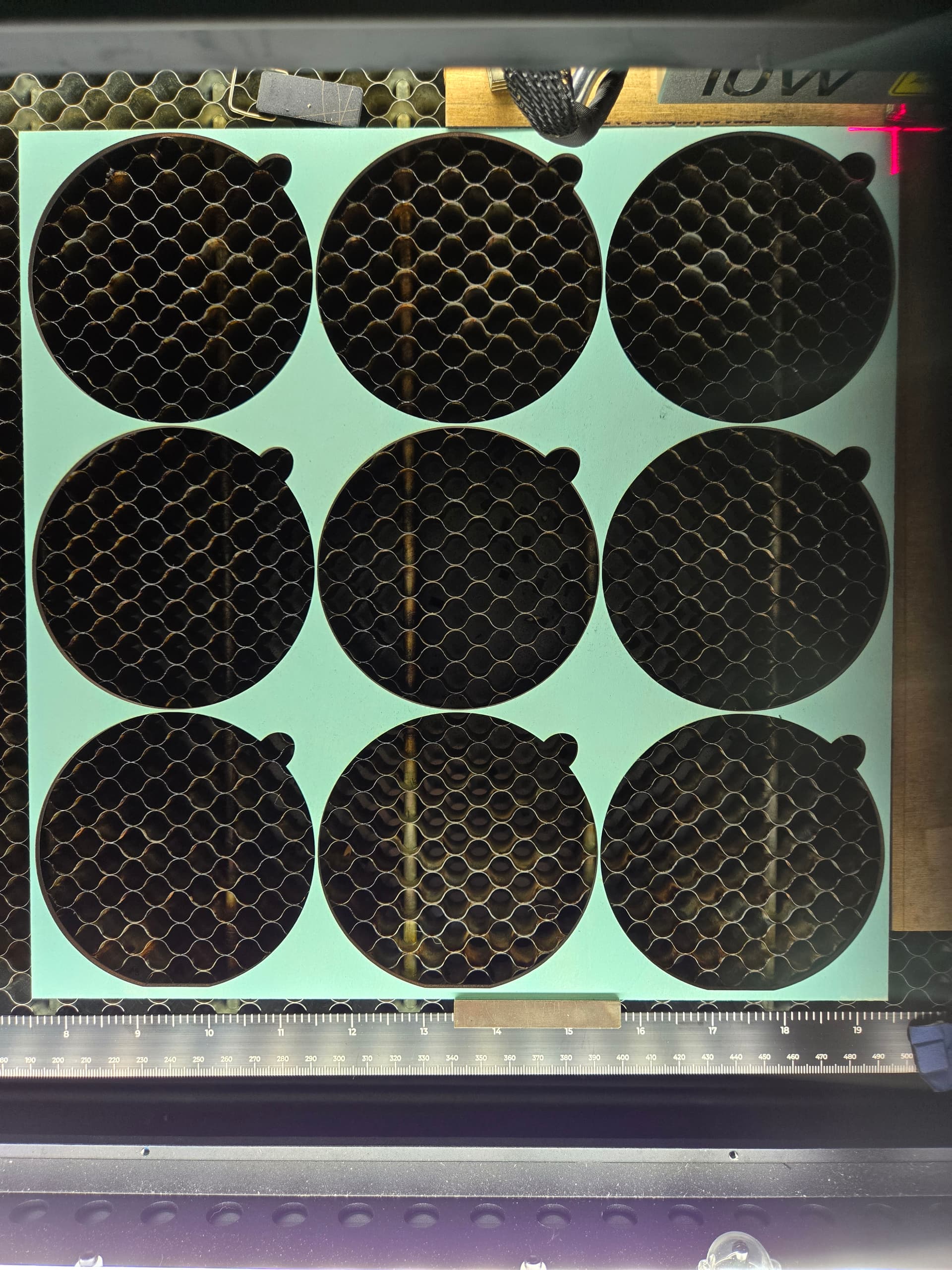

Thank you for your help. I reset my pointer offset (it helps to start job origin in CENTER, instead of top L corner during the reset phase). Turns out that the new XY was pretty close to what I was using before. The MOST important thing I learned was about the “lost area”, so I moved my honeycomb towards the front, did a little adjusting to my corner jig, and voila… now I can successfully cut 9 circles out of a 12x12 board. Thank you and thanks for your patience with me!!!
