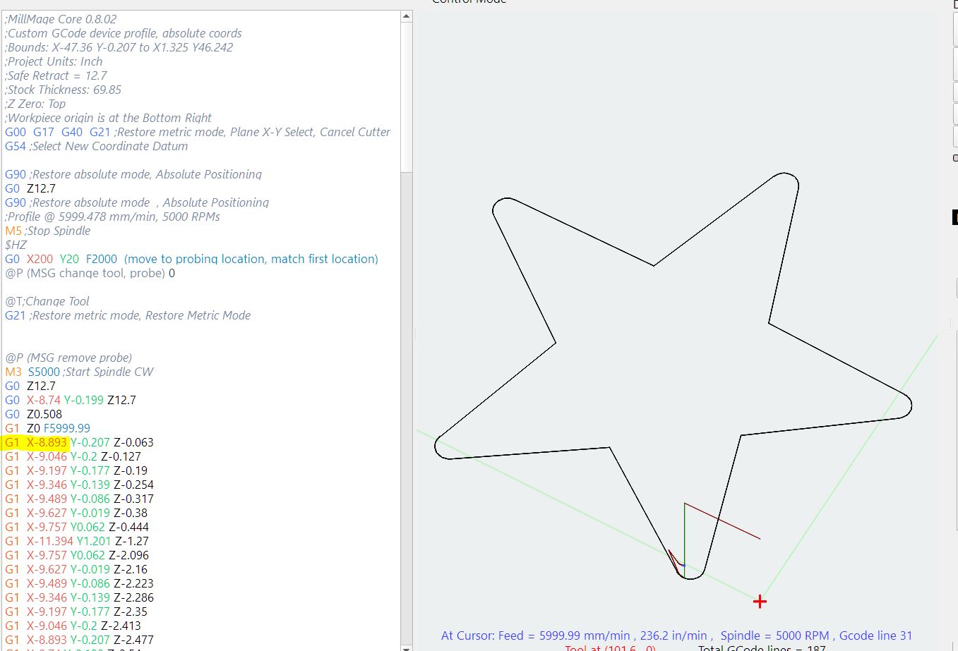

The Preview shows the star in the expected location. However, both Frame Outline and a dry run move approximately 4 inches farther left.
For example, MillMage reports X=-5.46 where I expected approximately X=-1.46. The difference matches the configured 4-inch stock width.
Is there another setting I’m missing when using Front Right as the project origin, or could the stock-width offset be getting applied unexpectedly during output?

The HelloWorld project is very rudimentary. I haven’t really gotten to the stage of setting up speeds, but this should do.
You can see the shape has just under 2 inch width, and the workpiece size is 4 inches (good round number, larger than the shape).

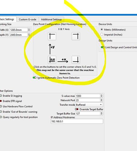

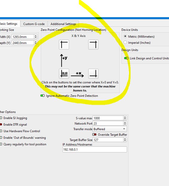

Where the machine goes is where the Home position is located. It is determined by the limit switches and is fixed. YOU have to tell MillMage where that corner is located. Most CNC.s have it at the front left corner of the table.

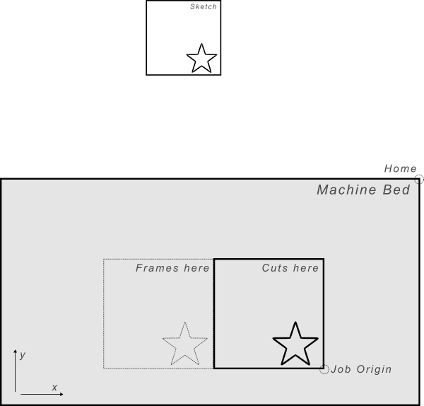

Here are the videos of a dry run and an actual cut. In each of these you can see framing being far off.

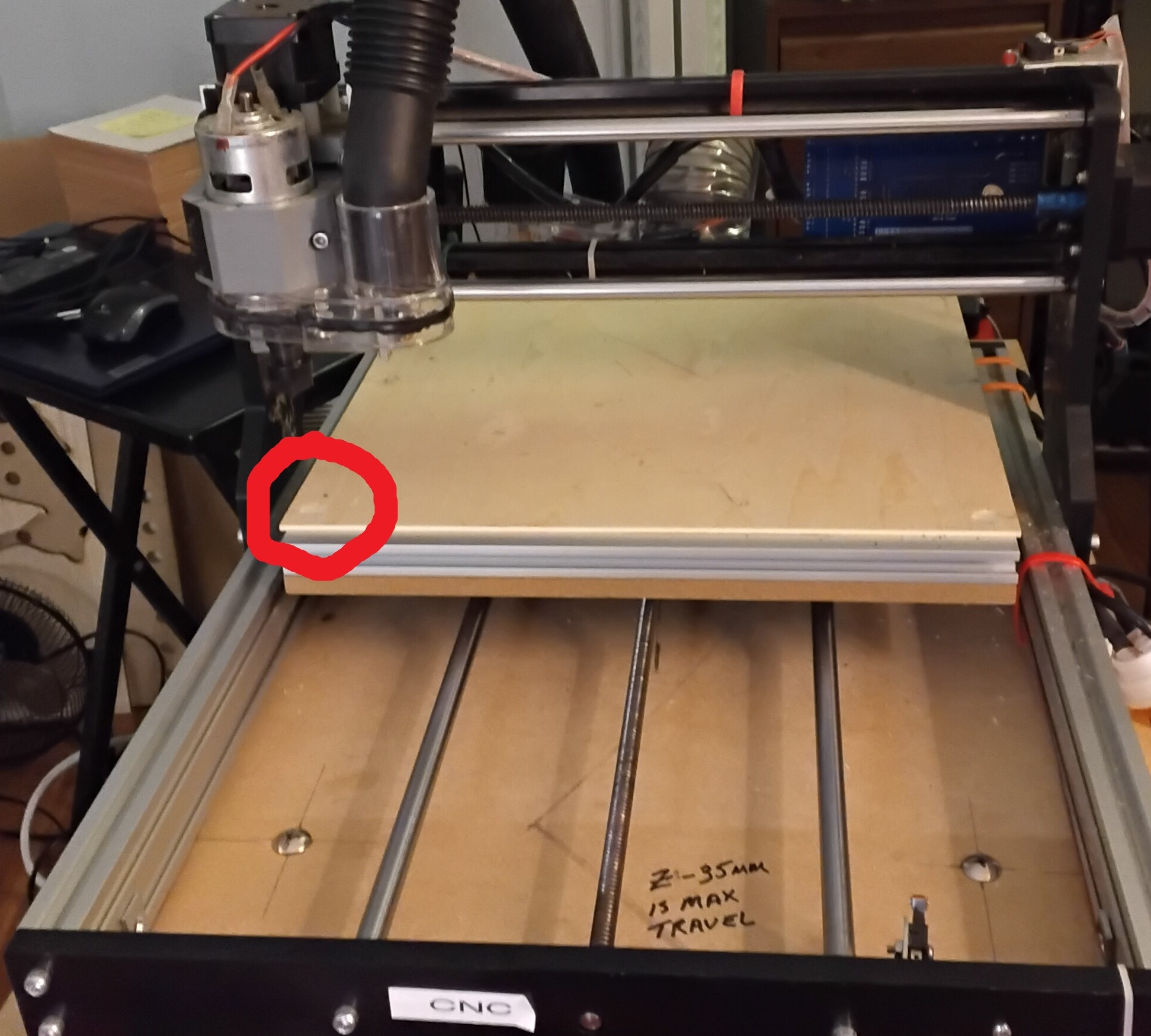

If the material was located next to the back right corner, would framing be correct?
If the material size included the back right corner, regardless of location, would framing be correct?
I’d like to confirm that the behavior here is related to the workpiece size setting.
The problem is actually with left/right positioning, like captured below.
The framing offset is always one length of the workpiece.
If you have a Shapeoko Pro, your machine origin in the back left is correct.
@MikeyH Remember that HOME and Machine Zero are not always the same. We have a lot of machines that we support that home in the front left but X0 Y0 are back right. I have 2 in my shop that are common grbl machines. This is also expressly said in the device settings page for Machine Origin setup.
