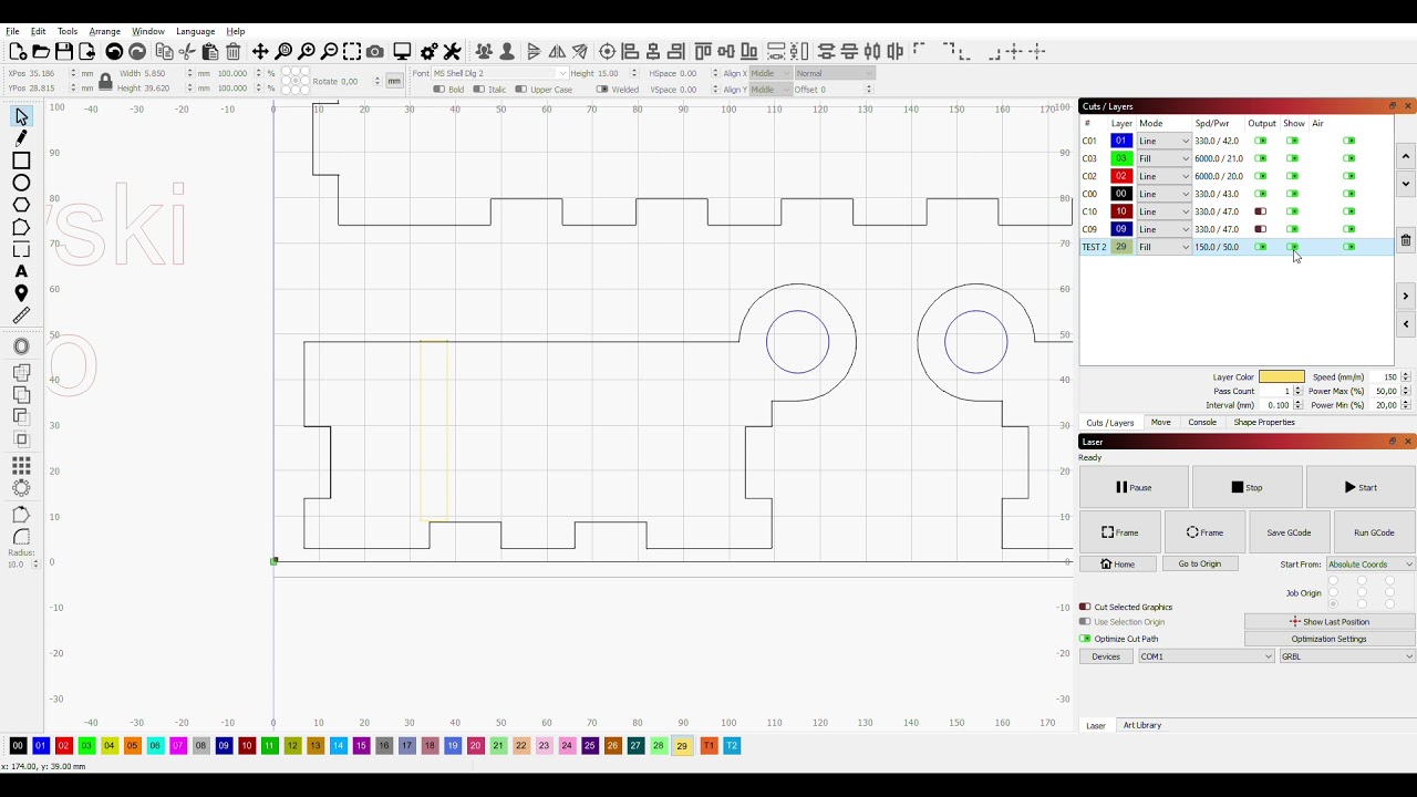

I have objects that are grouped together and want to ungroup so i can assign a different layer to one of the (2) objects in the group. Doesn’t work. I have tried saving, closing and restarting. changing the layer color. I have asked nicely and cussed at it. Nothing!!

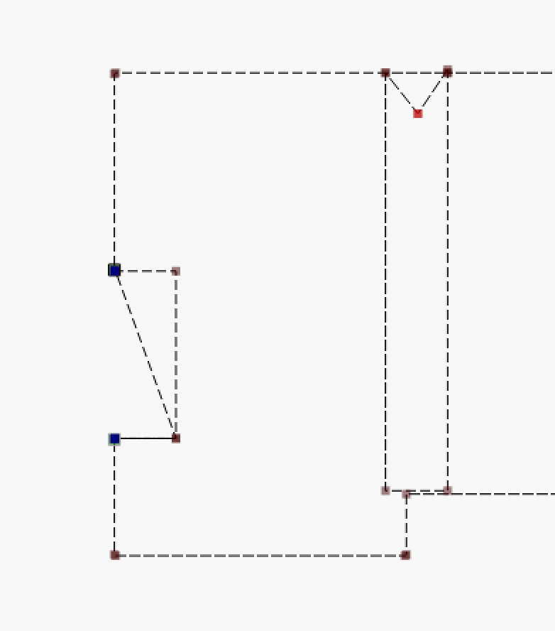

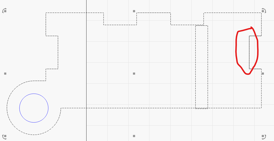

Not sure why but there’s a redundant line in the design that I think is screwing things up.
I suggest you rebuild the object:
- Select whole object
- Arrange->Break apart
- Select all pieces making up one part and do Edit->Auto-join selected shapes
- Repeat step 3 for each individual component
This is because there are some double lines and points that lie on top of each other and are part of the shape.
