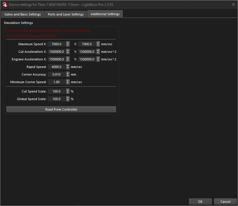

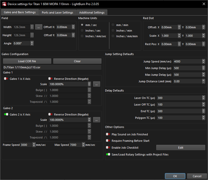

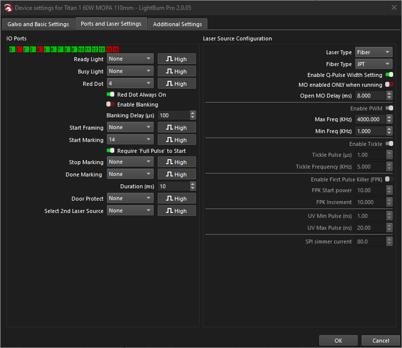

Here are my device settings:

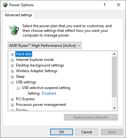

And USB setting in power management:

The freeze you described is something I’ve seen when the fiber source setting in Ports and Laser Settings tab is sent incorrectly. You have it set to JPT, which is what I would expect - I have yet to find
