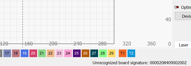

I have a 30wat fiber laser. I have used this for over a year on lightburn with no problems. 6 months ago LightBurn stated unrecognized board signature 0000208409002002 and i made a post about it. No successes on fixing it. I’ve made it work at times, but now there is nothing i can do.

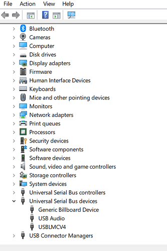

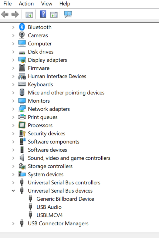

What does the galvo device look like in Windows Device Manager? does it show up in the ‘Universal Serial Bus devices’ list? Or somewhere else?
The board signature may not read very well if the USB bus is insufficiently powered (read that somewhere here but can’t find the reference now), so try using a different USB port (e.g. from back of computer instead of front, or from an externally powered USB hub).

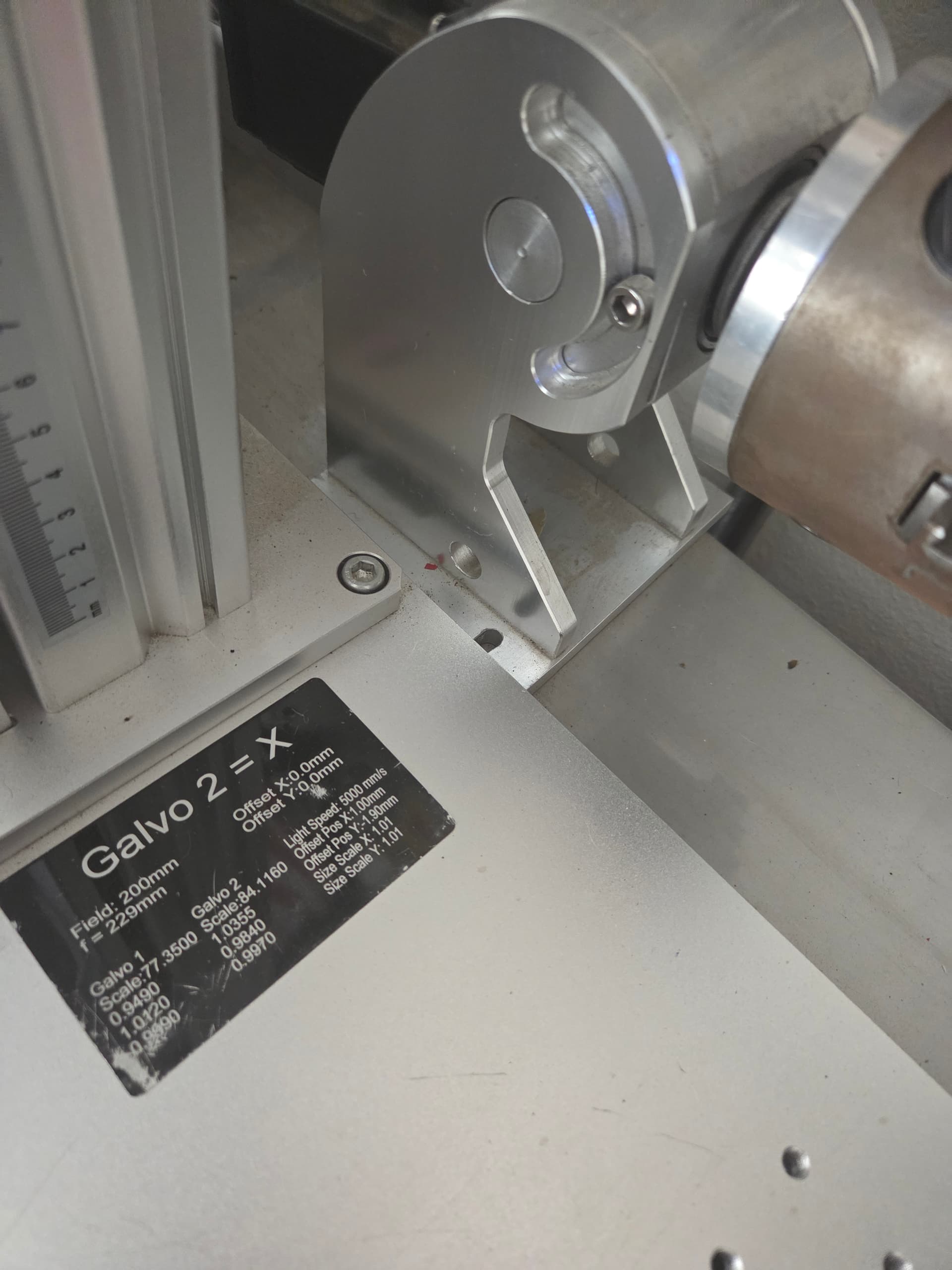

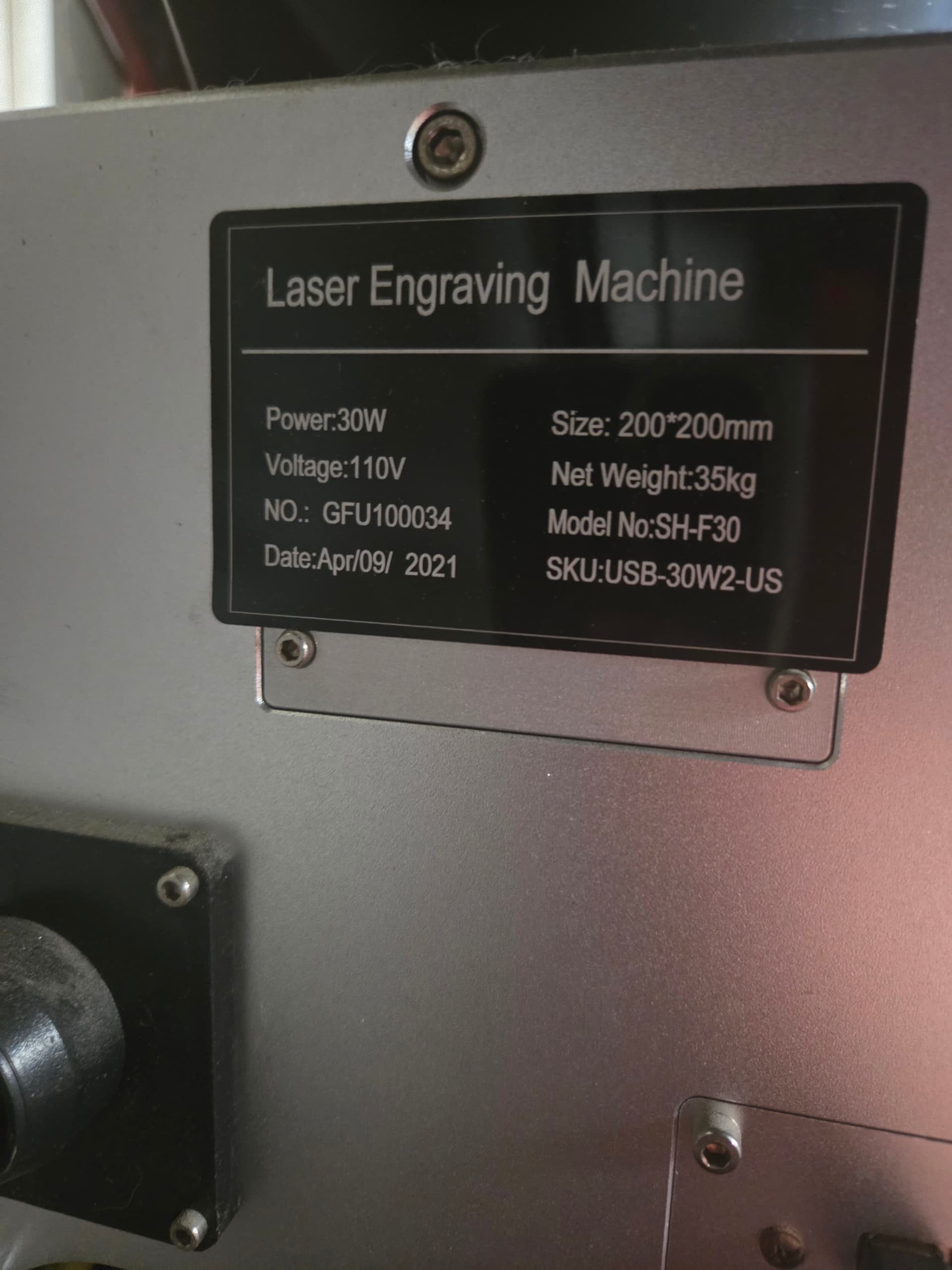

Regarding a candidate for board replacement, it might help to get a good closeup photo of your existing board first. Ideally showing model & revision number.

Also, here is the device manager. I’ll open the laser up to get a picture of the board today/tomorrow.

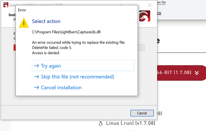

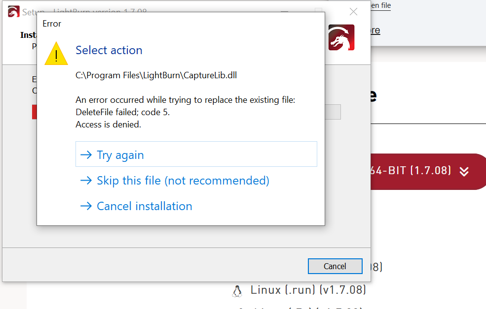

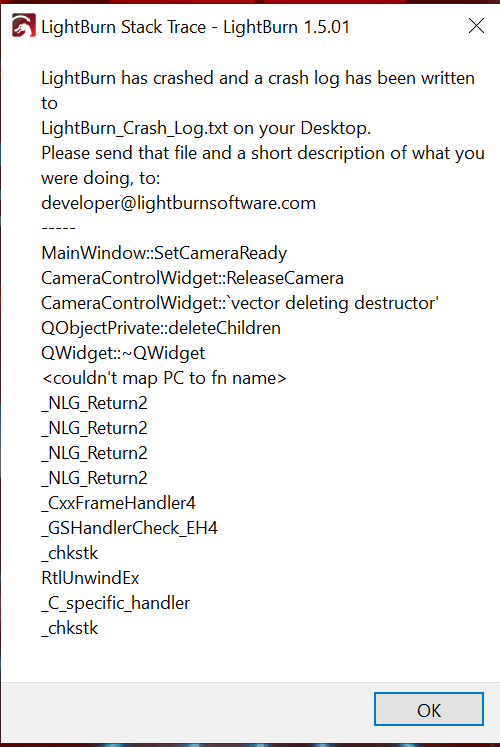

Also, I tried to do the download but this came up
Make sure that LightBurn is not already running and try again. If same problem, reboot the computer and then try the install again.
did the update, but its still not working.

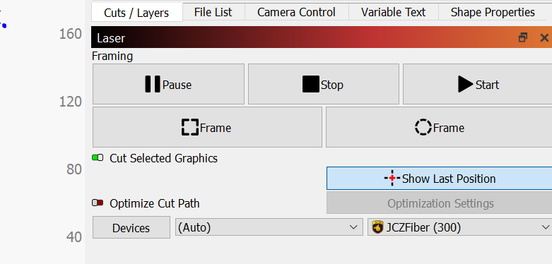

What does your ‘Ports and Laser Settings’ tab look like?
