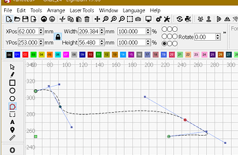

Hello,
How to select 1 or multiple nodes and move it to a defined x,y location ? (XPos,YPos)
Can’t we have a XPos,YPos for nodes when entering the Node mode ?
Thanks for support
Regards

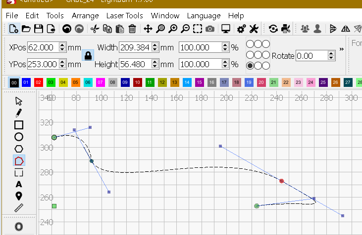

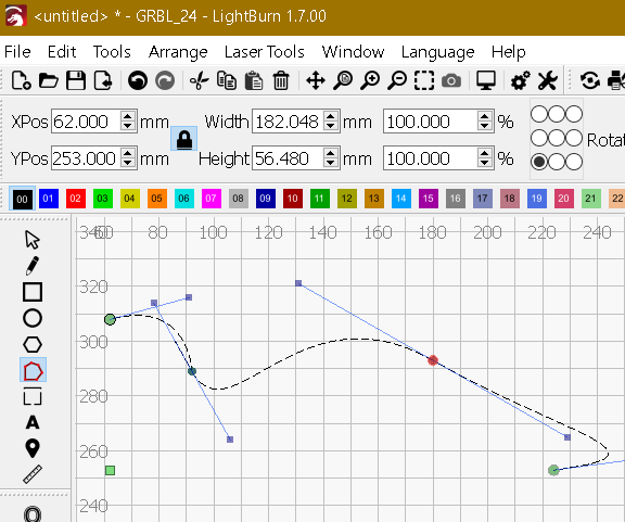

mark the node and enter the desired coordinates, have you tried it?
Does not seem to work, unless I am doing something different
X/Y coords are still for the whole path by its origin marker
ye like gilaraujo said it does not work that way .
If you do that it will move the entire shape
This is not currently supported in Node Edit mode. I suggest this is worth placing on our Feature Suggestions site, where others can upvote to show interest. We track and use this information to help prioritize our efforts. :slight_smile:

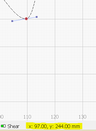

The best I can add is looking at the coordinates when you drag the node.

Ty for answer but this is not the node position it is the cursor position.
You can try to hoover precisely on the node but it is way to messy and unprecise.
Should have a panel displaying the node X,Y pos when you click on it

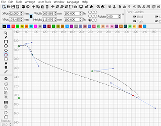

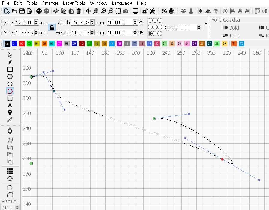

It works, but you have to zoom in a lot to be accurate.
It is correct after I tested it I could better understand the problem itself. It is a little strange that it does not work because it is possible to move a node with the arrow keys individually … and you can see the changes in x, y and wide, height fields.
WTH
With the arrow keys there are areas where I can move the node but without changing the x and y.
I think Lightburn does not have “built -in” viewing and direct manipulation of individual nodes with coordinate input.

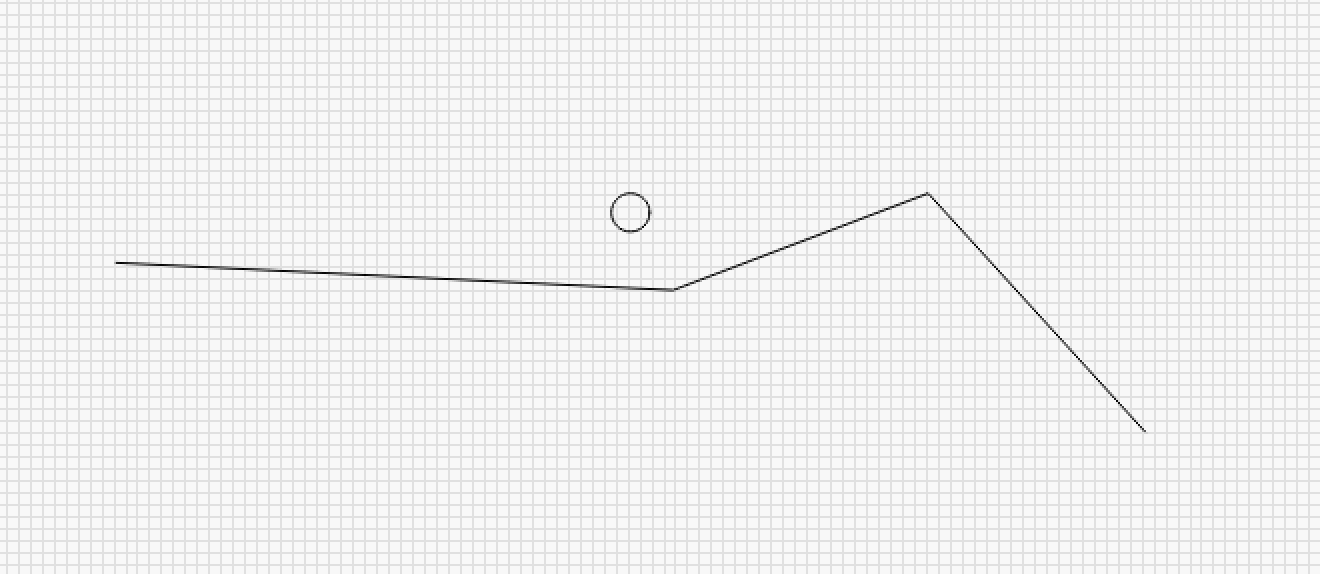

If you use a circle, line or other shape, the center point of these is used in displaying the coordinates.
In picture, the coordinates of the circle and line are the same i.e. represents their center.
