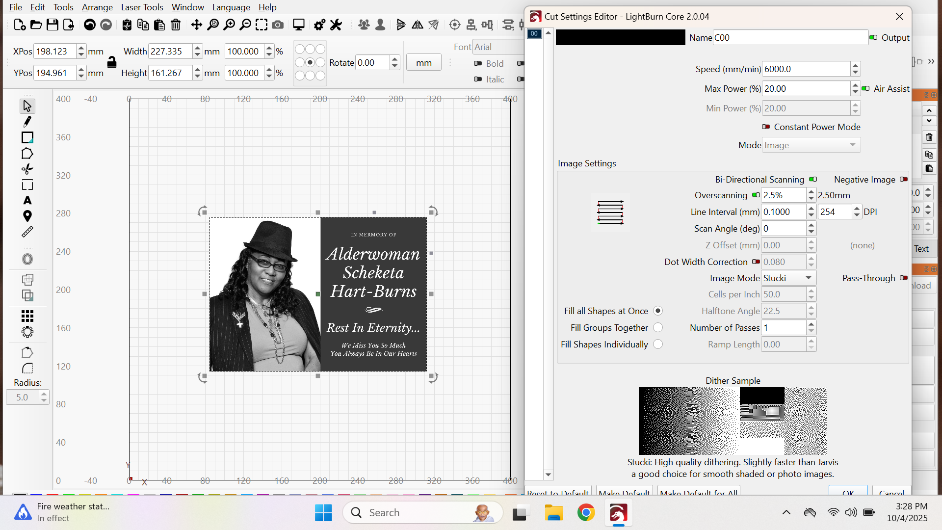

So I am attempting to Engrave on slate 10x9. For some reason it ends up small and I think I have the size right.. Any Suggetions?

Show screen shots of your settings, your file and your cuts/layers that you are using.
You are funny… Here are the settings, And to be more specific, it is engraving what I want to engrave. 9x4 blah blah in., and it’s set at 9x7 in., which is a 10x9 in. slate..
Please also show your results, so we can compare.
Include the screen shots of your machine settings.
And, you are welcome.
BLAM! Press the in/mm button and you get… 8.9 x 6.3
