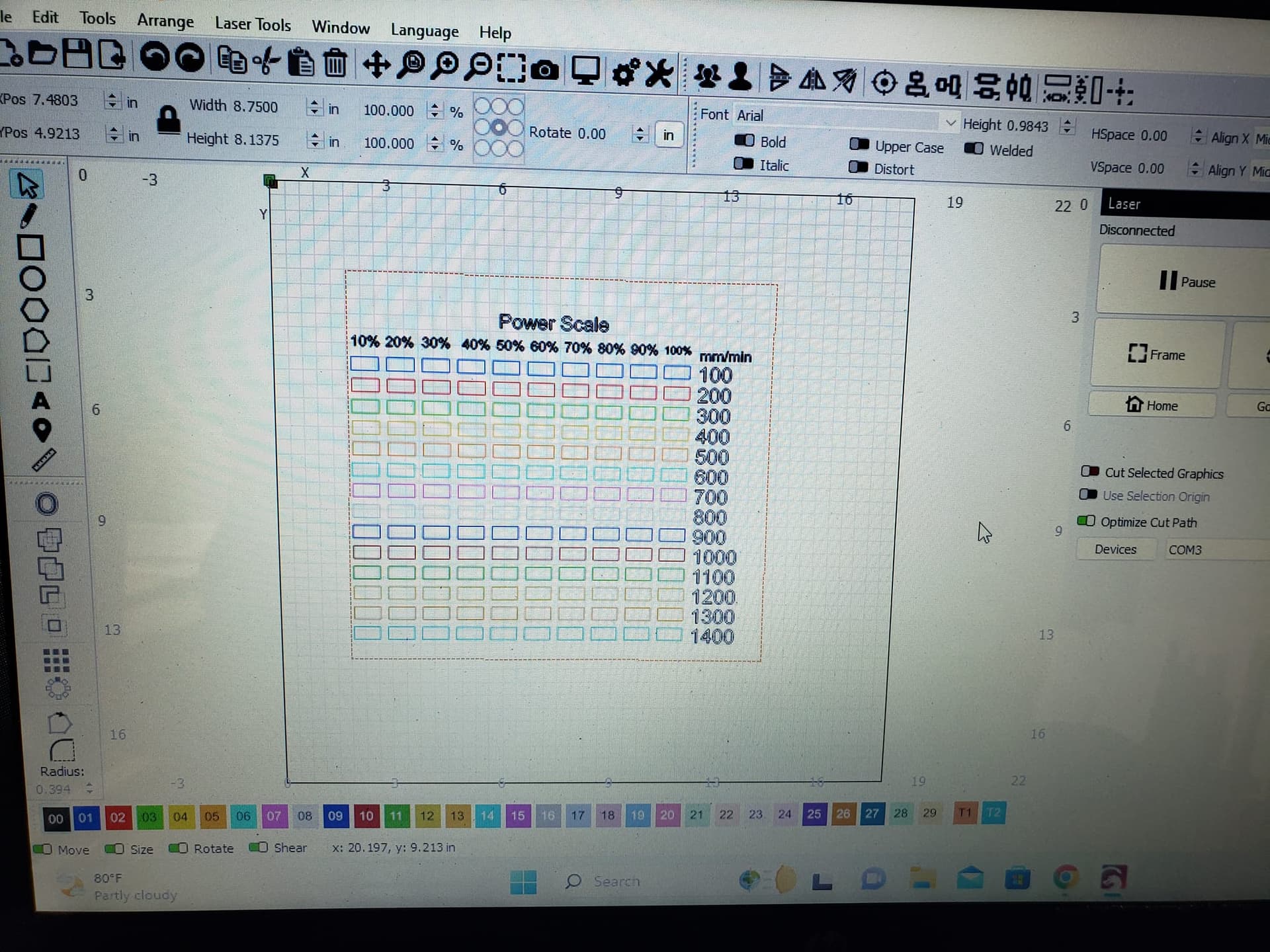

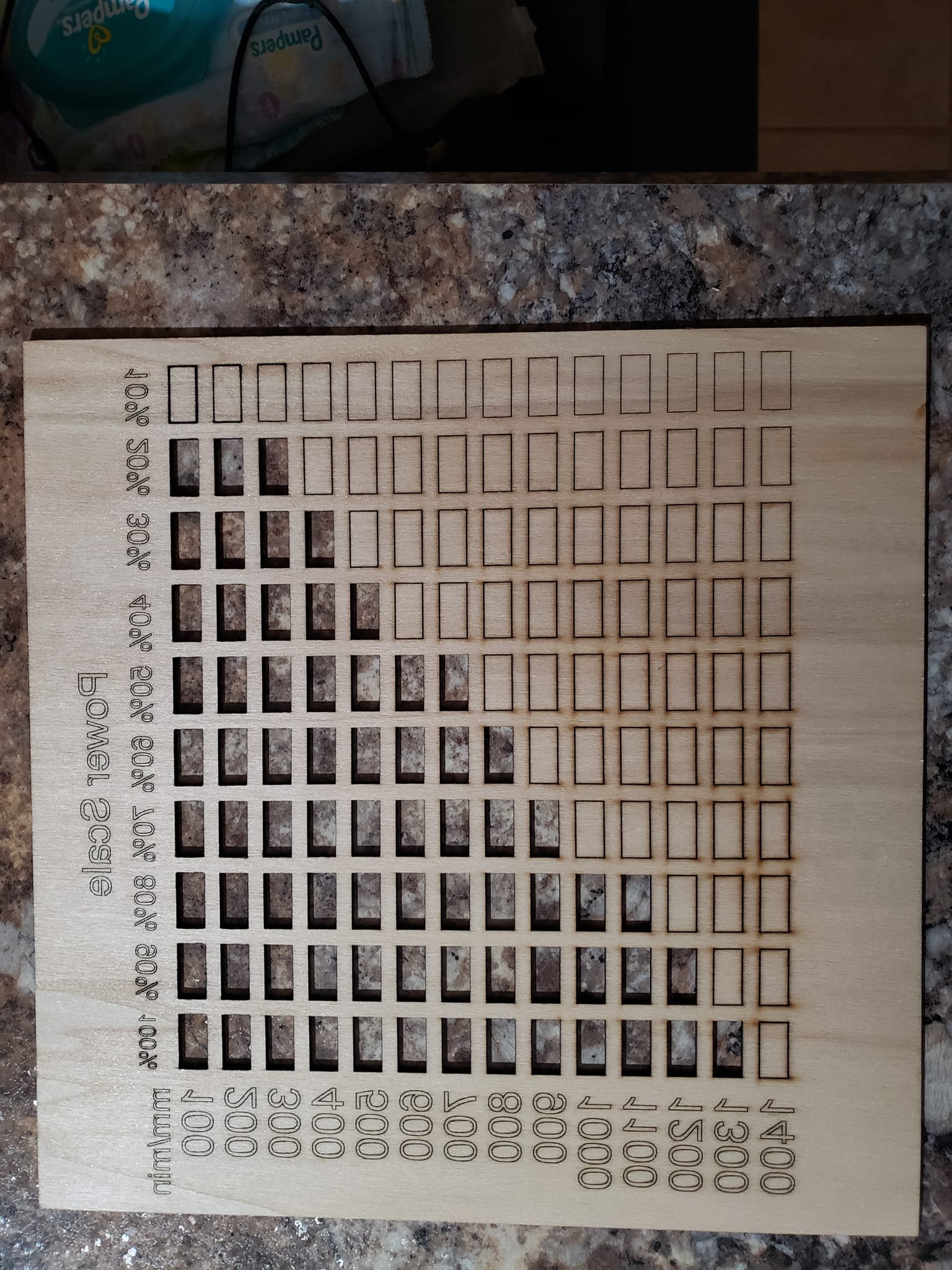

When I run a test grid (using lightburn material test) is prints out as a mirrored image. This also is happening with other files. How do I fix this?

Can you take a full screenshot of LightBurn with your design loaded and a photo of the resulting burn?

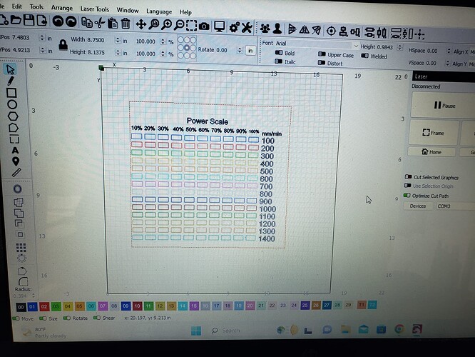

Okay, here’s the pics.
Go to Edit->Device Settings. Change the Origin setting from top-left to bottom-left and push OK.
Note that this will cause the design to reorient. Fix the orientation of the design and test the burn. This will likely require a vertical flip. You won’t have to reorient in the future. It’s only an issue this time because the design was already loaded during the Origin change.
