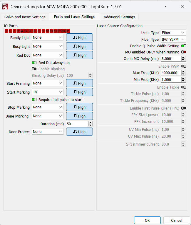

Update 1.7.02 possible issue with fibre
That’s the bug I just fixed. We’ll have a patch release out shortly to correct this.
Yeah man, just adding that a brand new machine is fine red laser is okay :slight_smile:
My red dot settings on both of my machines. Cloudray 50w and Cloudray 60w mopa. Just for info. I haven’t upgraded yet until the patch version comes out.
Interesting mine is marking 15 and my fiber type for mopa is JPT usually on our machines
I emailed cloudray with a screenshot. They said it’s correct. Imported the markcfg7 config file.
markcfg7, how interesting, thanks for letting me know!
I have also contacted the manufacturer… lets see what they say.I will also report back after their reply…

I think I am running in to that same bug, with LB ignoring the global passes setting. Strangely, it was working. But between me upping the speed and playing with optimization settings, now it just ignores the global passes setting. Turning optimization on and off doesn’t effect it. Having tried slowing it down to see if it works again.
1.7.03 update is out and has fixed my issues
Checked this morning and its working for me again. THANK YOU.
Just a little feedback on this : I have now replaced the 650nm laser for framing and it works again. Yes… it was a failure on the red laser module! Wild coincidence… but the dev was right (as usual)… :sweat_smile:
