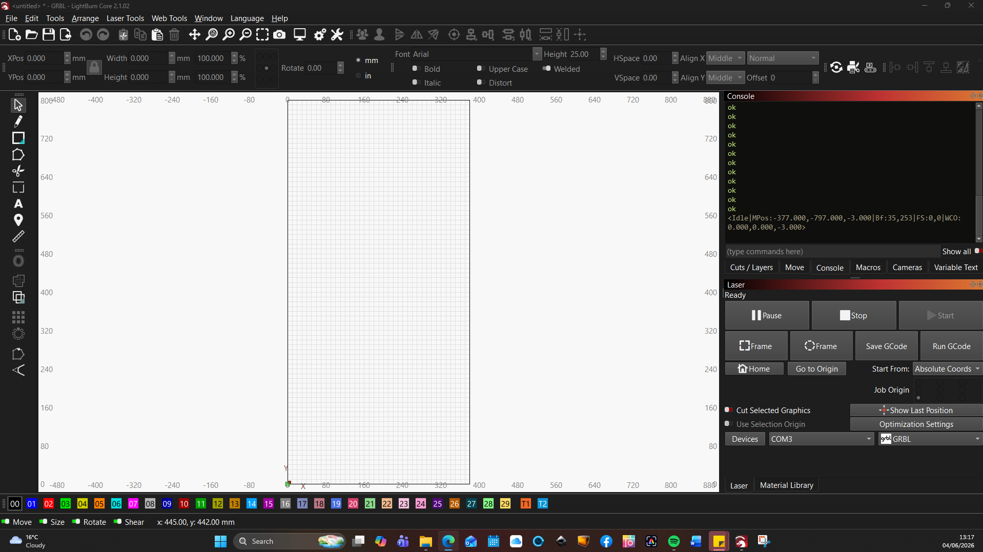

This comes up after Homing is complete.
Thank you for the screenshots. We’re getting there!

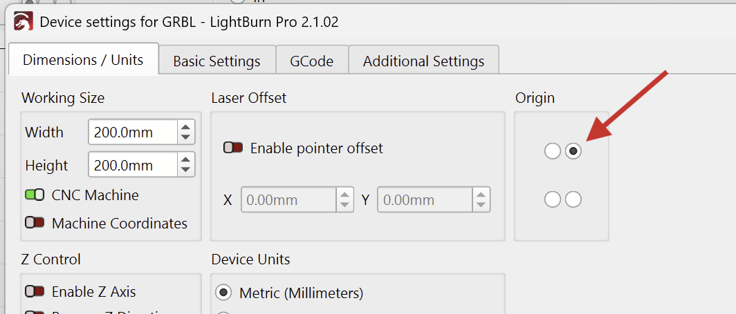

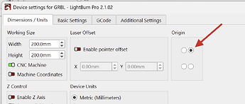

Then, you need to change the Device Origin in the Device Settings. It should be set to top-right, if I’m not mistaken

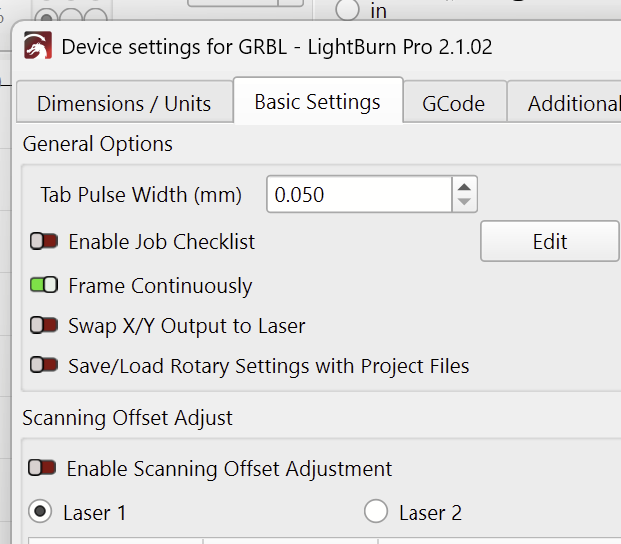

Is “Frame Continuously” still enabled in the “Basic Settings” tab?

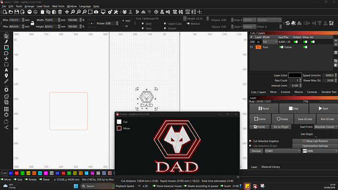

Hi Back again okay all seems ok for homing and framing now. just when i did jobs before estimated time was bang on now it seems to be a fair bit out as running over the estimated time.

As for the preview times (Not sure why that would change on its own):
Open the “Additional Settings” tab in the Device Settings, and hit “Read From Controller”.
This docs page provides more details:
