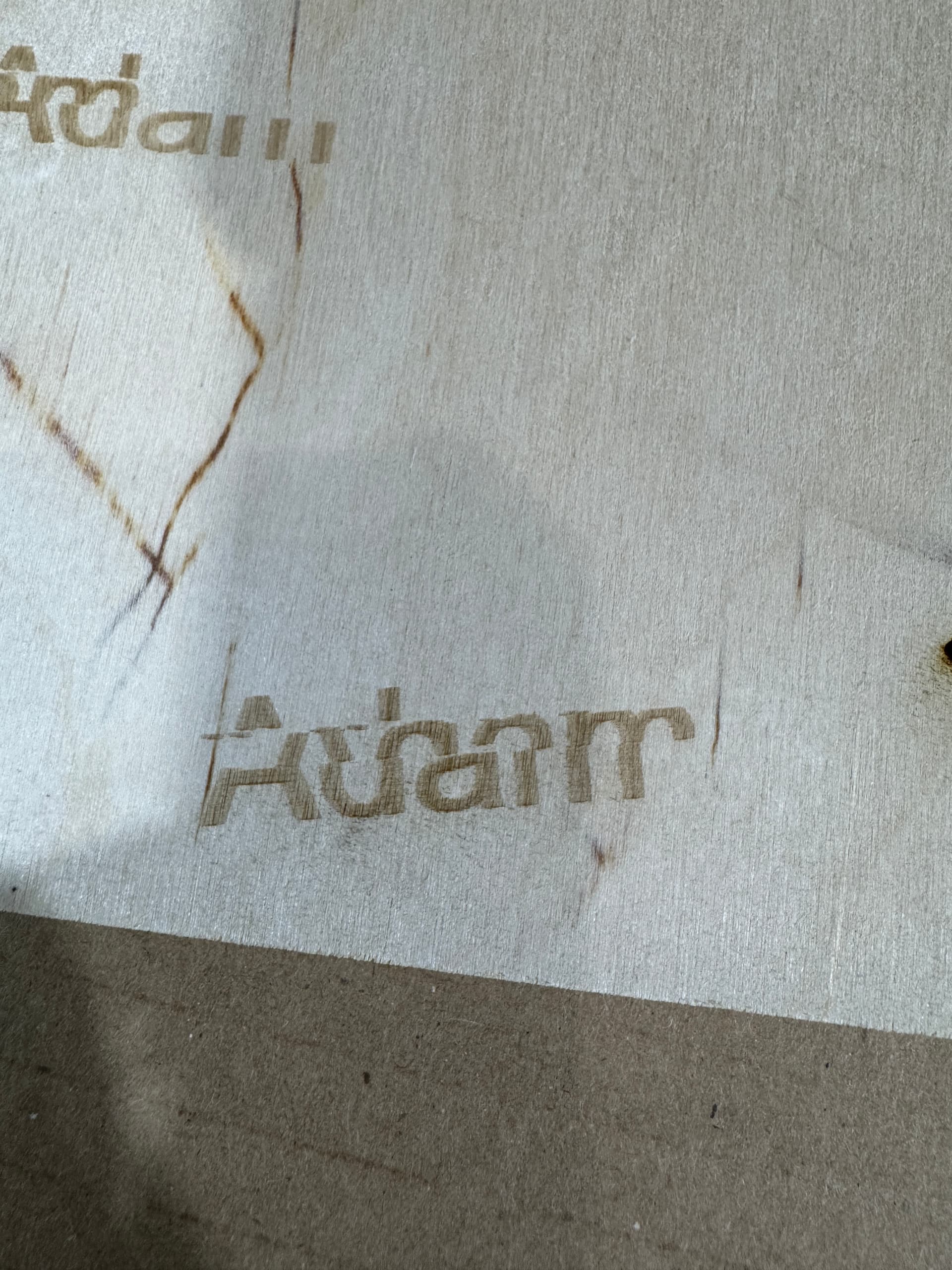

Same here. have a Monport GA30 mopa fiber and it will run on version 2.0.02 on my Mack but version 2.0.03 dosn’t. i resorted to running 2 versions of light burn. one for my fiber, on version 2, and my co2 on version 3. Oddly enough, my Omtech 80w co2 got a really bad bug where the letters we lasering, then the machine head would move and it would finish a bit in another spot, so my letters where essentially in pieces… as soon as i installed v3 it went away. just for fun i loaded v2 back up to see and the problem came back.
