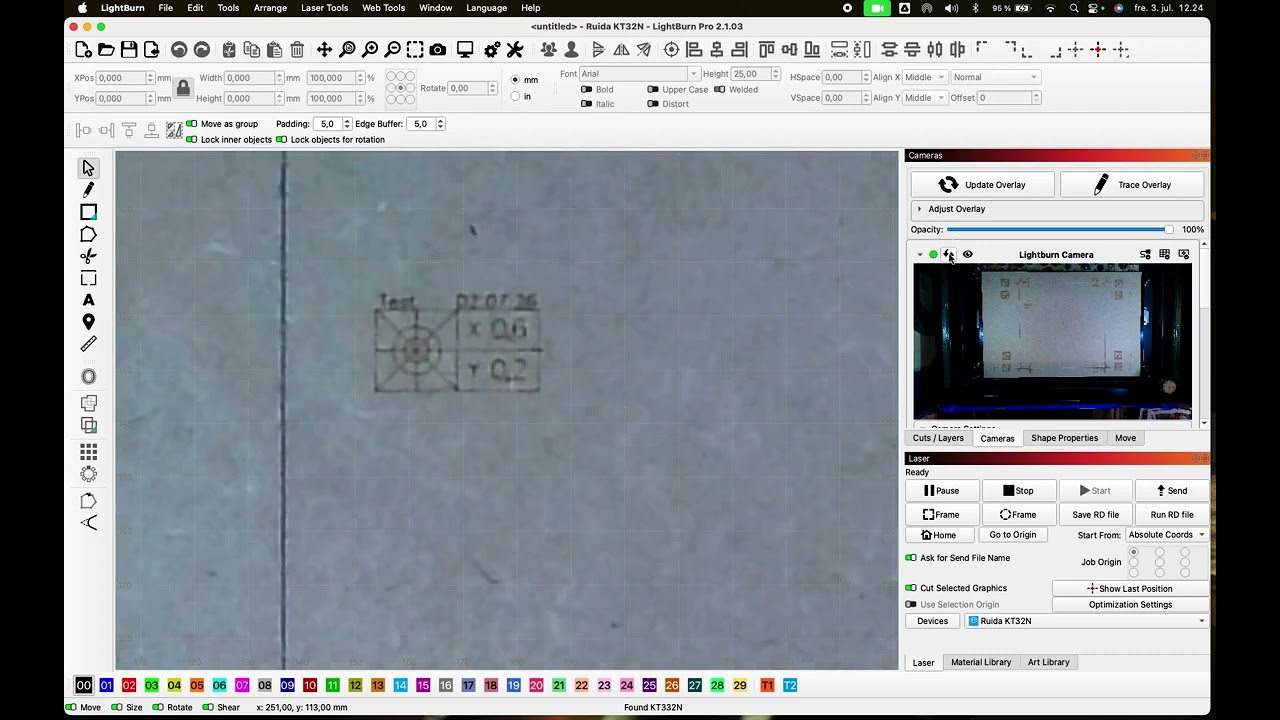

After a few hours of working with the LB camera, the update overlay no longer works as expected.
The update is displayed with much lower resolution than it should, while the 4th option shows the correct image, see the video.
I have reset the LB and the computer without it having fixed the error.
Hi Bernd
Could you expand your Adjust Overlay and see where the DPM slider is at?
Thanks, problem solved
I must have turned it down completely by accident and not noticed it :expressionless_face:
I saw the DPM control but was not sure how it affected the camera operation..
assuming it should be set to MAX, but does it slow down the camera or affect anything else ?
Let’s put it this way, if you don’t use max resolution, the image will be pixelated. So much so that it’s useless for LB tasks, in my opinion. If you have a computer that can’t handle the maximum camera resolution, there’s no point in installing a camera either. My Mac Book Pro from 2014 handles the task without any problems, I haven’t tried my Windows 10 computer with the new camera setup yet.
