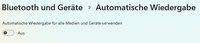

When updating LightBurn on Windows 11, “AutoPlay” must be turned off. See the button in the attached image. Please check this setting before performing the update.
You shouldn’t see Error 5 anymore.
