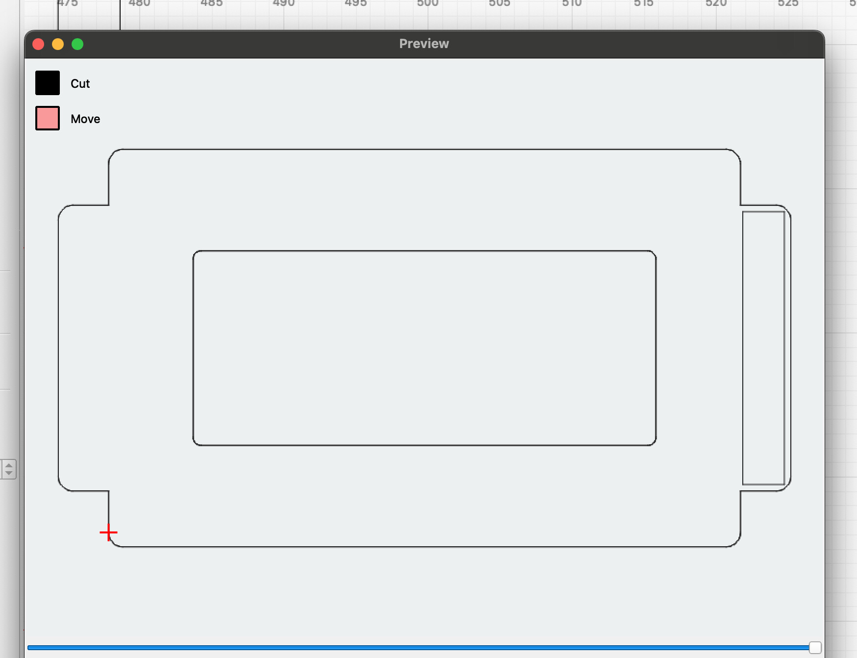

In my opinion the preview window shows your set values accurately. However, I don’t understand why you are using positive and negative kerf at the same time, that is not the “correct” way to use the kerf function.
Unless you have a specific reason to do so, “only” one kerf setting is used to achieve the desired fit. (I use 0.075mm for a tight fit in 3mm BB)

I’m just confused by the fact that you use plus and minus. Put it all on the same layer and give it 0.2mm or whatever it takes, but not plus and minus :wink:

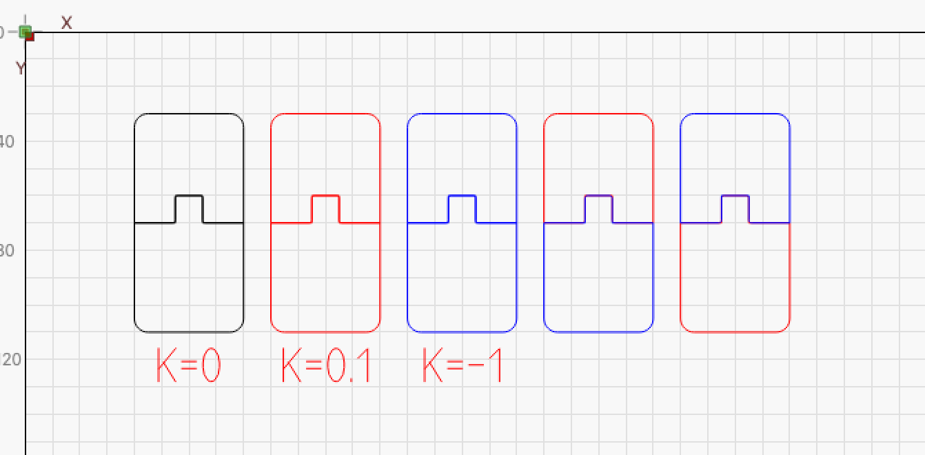

I like to use visualization of problems, it sometimes makes things easier to understand for me.
Here’s a little kerf test that demonstrates it nicely, I think.
(see results in the preview window and mix the parts)
Kerftest4.lbrn2 (18.1 KB)

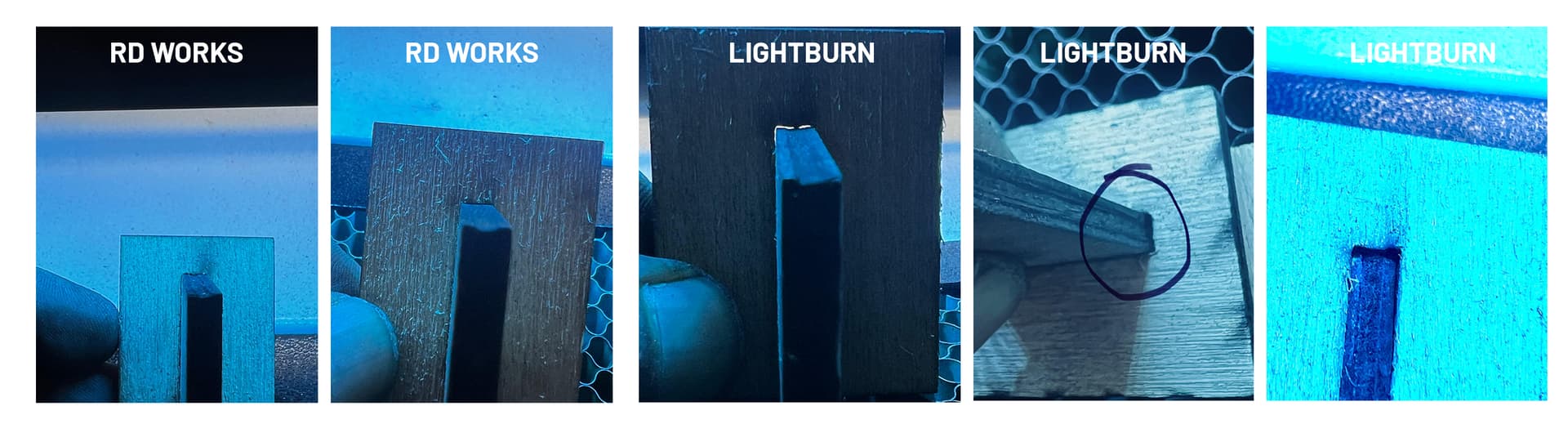

“The cutting results from LightBurn and RDWorks are below. Yes, I’ve reverted the issue status back to unresolved.”
This is a 3 cm part cut, and there’s already this much deviation. As the part size increases, the discrepancy also gets larger.
Thank you

Just to share an update: unfortunately, the solution we found was to stop using LightBurn, despite having a paid license. We’ve switched back to RDWorks, which runs without any issues for now.
Currently, we’re facing a consistent Y-axis distortion about 25mm of elongation on a 30cm cut piece when using LightBurn. RDWorks doesn’t exhibit this problem at all.
