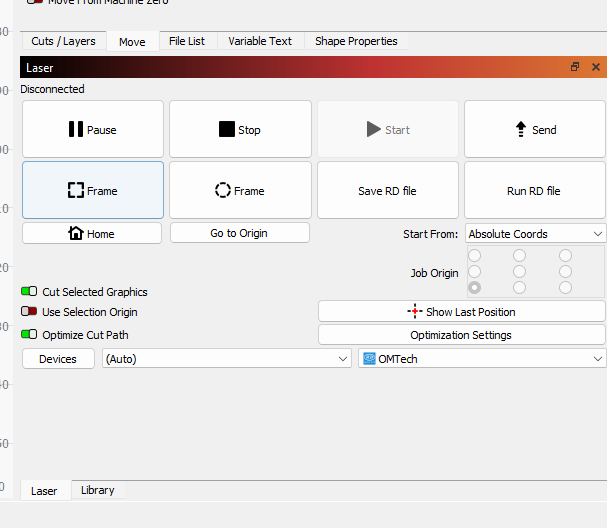

When I click frame, even though the file shows in the upper left of the screen, the laser frames at the bottom of the area. If I try to send the file, I get “out of bounds” warning but it will cut fine still, though different from what it shows on the screen. It’s at the bottom (like the frame) and the image is upside down/mirrored. I’m sure there’s more happening but I’m so frustrated I don’t even know what to do…
This is usually caused by the wrong origin in the device settings.
Can you post a screenshot of the device settings and let us know what corner the machine homes when it boots?
It homes in the upper left (if looking at the machine)
Are you using absolute coordinates or other origin? When you updated it may have changed the Start from setting.
It doesn’t matter which setting I choose there, it still starts from the bottom of the bed area and cuts mirrored.

Smoothieware K40 machines are typically configured such that Origin is bottom-left. Change that and retest. Jogging controls should work in the intended direction and framing should position corresponding to position on workspace.
What are your results?
Yes, the fact that your machine starts from the bottom is telling. I would set your origin bottom left. Make sure you do not have a design open when you change your origin. Open an new lightburn workspace and change the origin, then open your file.
What is the proper origin setting? Is it where laser goes when issued the G0 X0 Y0 command?
And if Lightburn uses positive coordinates then wouldn’t be bottom left?
It doesn’t appear to be mirrored anymore, but it is still alerting me to “out of bounds”, only using the bottom part of the bed area, and jog down and up work.

Sometimes when you update LightBurn, windows will do strange things, like ignore your preferences/settings. Go to File>Load Prefs Backup>Select an option that worked for you previously to get your settings back the way they were.
This worked…sort of, so THANK YOU! I still seem to have some sort of gremlin in my system that has moved the placement of all of my files on the screen, but that is an easy fix and I’m finally cutting again, so I’m gonna take that as a win and CREATE!
