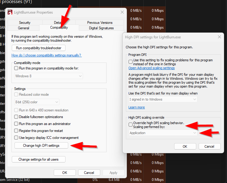

To address the issue
On Windows
Navigate to C:\Program Files\LightBurn
Locate LightBurn.exe, select the file and right click > Properties
Click Compatibility Tab at the top
Click Change High DPI Settings
Make sure the “override High Dpi Scaling Behaviour” is unchecked
[image]

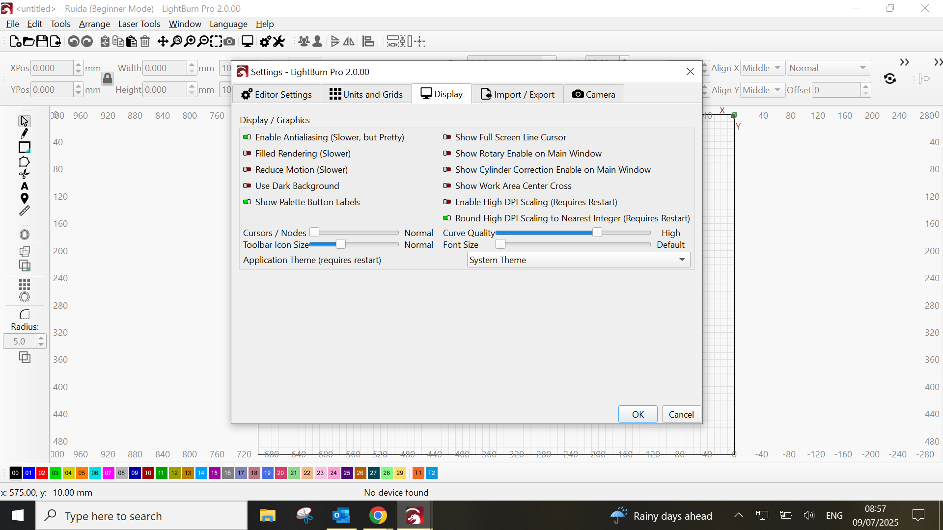

On LightBurn 2.0:
Vladica
(Vladica)
July 9, 2025, 7:09am
3
just uncheck in settings (enable high dpi scaling)
