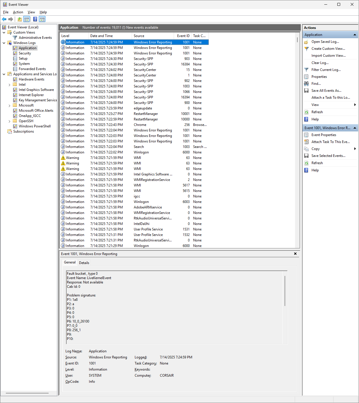

I was running the last version of lightburn 1.708 just fine, no issues. Tried to update to 2.01 today and lightburn wouldn’t open. I double click the icon would see a really quick circling mouse and then nothing. Not a flash screen, nothing. I found a forum topic in the past about installing the latest VS C++ redistributables, tried that, uninstalled, reinstalled a few times, still nothing. Deleted any remaining folders, preferences etc. tried fresh install again after reboot and still won’t open. Had event viewer open while trying to open lightburn and I don’t see any red errors related to lightburn. I attached a screen shot, the top 3 windows error reporting was not even at the time i tried to run it, so idk. I Tried to run in admin mode, shift click icon etc. Still nothing.
I just tried to install it on my laptop and had the same issue, so i uninstalled it, reinstall 1.708 and that is working fine again just not 2.01.

Same/similar problem. Win 11, laptop and desktop both don’t want to start 2.00.01 and I’m at a loss what to try. Removed old C++ runtimes (all of them and reinstalled just the latest of newest) to no avail. Watching in the Event Viewer I’m not seeing any sort of corresponding messages there. No “Com Surrogate” running that I can find in the task viewer. Rolling back to 1.7 works fine.
I looked at the antivirus history and it doesn’t appear to be. I added lightburn to my firewall and they didn’t change anything either. Still doesn’t work.

Just saw the 2.0.02 version available and installed it and it’s working fine so :+1:
