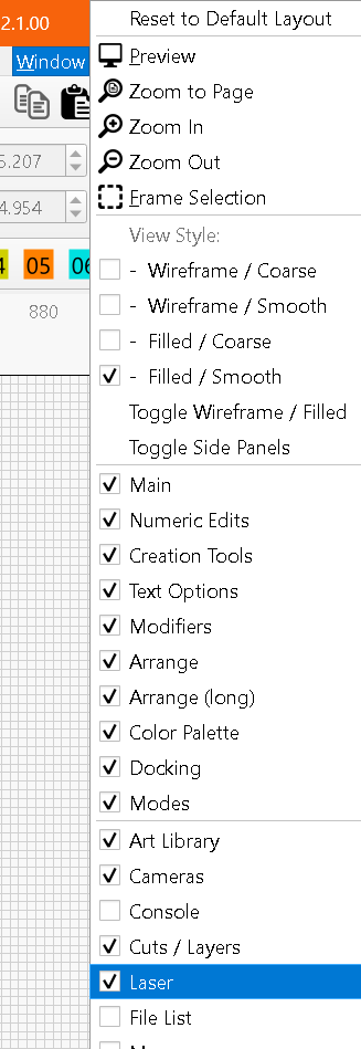

Updated to the new Lightburn Pro 2.1.02 cannot find how to frame (preview cut/engrave area)
OMTech 50W/Ruida/Windows 11, upgraded to the new 2.1.02 and there USED to be a button I could click and have it frame in the area that would be cut/engraved below the “cuts/layers” window but now it’s got a “Material Library” window there. HELP! I need to engrave hat clips and need to frame them in so they’re centered.
Maybe you need the Laser Window?
YES!!! Thank you!
