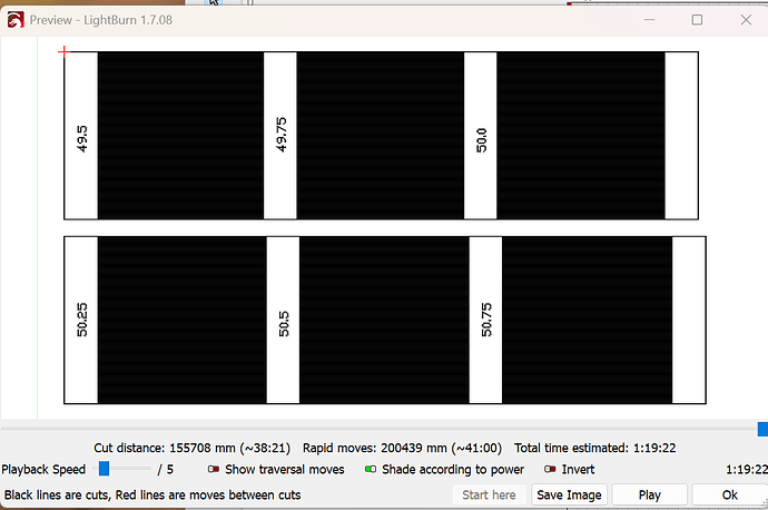

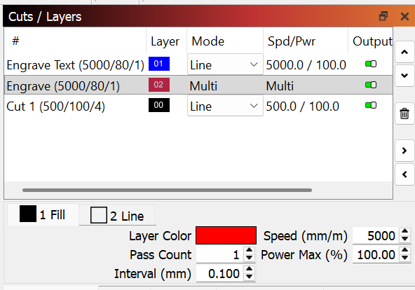

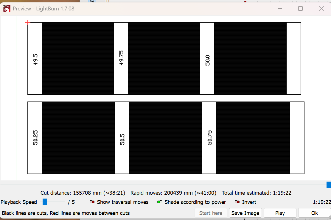

When loading a file from version 1.7.08 into 2.2.00 of lightburn, the project has different speeds. Also for creating new projects, the speeds don’t seem to match the expect preview times. For example, here are the speeds for the project as shown in 1.7.08:
And the preview indicates it will take 1h 19m to complete:

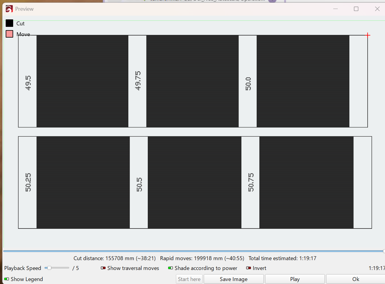

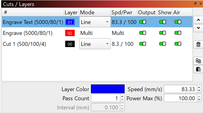

Loading the same file into 2.2.00, the speeds are reported as:
And again, the preview indicates it will take 1h 19m to complete:
If I manually correct the speeds, the preview then indicate it will take 35m. (With the cut and rapid move distances different as well.) It seems I can’t post more than 4 images at the moment.

Hey thanks for sharing your experience. Have you applied the solution from this article yet?
Brilliant thank you so much. I can’t believe I’d not noticed my speeds where mm/m in version 1.7.08, rather than mm/s.
