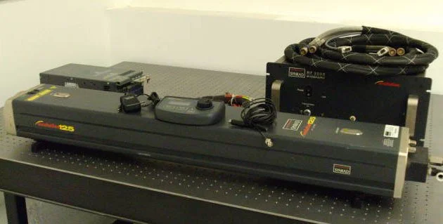

I prepare to change my old driver to Ruida and Lightburn
I need settings for my source Synrad Evolution 125
I cant find manual to download, one page returning error and on diferent one i find this
Tickle pulse
Evolution lasers require a 1 μs tickle pulse delivered at a 5 kHz frequency from the Controller. Tickle
pulses pre-ionize the laser gas to just below the lasing threshold so that any further increase in pulse
width adds enough energy to the plasma to cause laser emission. This tickle signal causes the laser to
respond predictably and almost instantaneously to PWM Command signals, even when there is consider-
able delay (laser off time) between applied PWM signals. Refer to Figure 3-2 for tickle pulse parameters
Is this a dc excited (glass tube) machine?
I believe this is what you’re looking for… Edit → Machine Settings → Laser Settings
You will have to open Vendor settings to access the laser settings. I believe this is already set to your values.
After thinking about this, I don’t think it’s active in glass tube machines…
Can’t tell you anything about how to get to the internals of your current controller…
Good luck
Synrad
Is this type of laser RF
