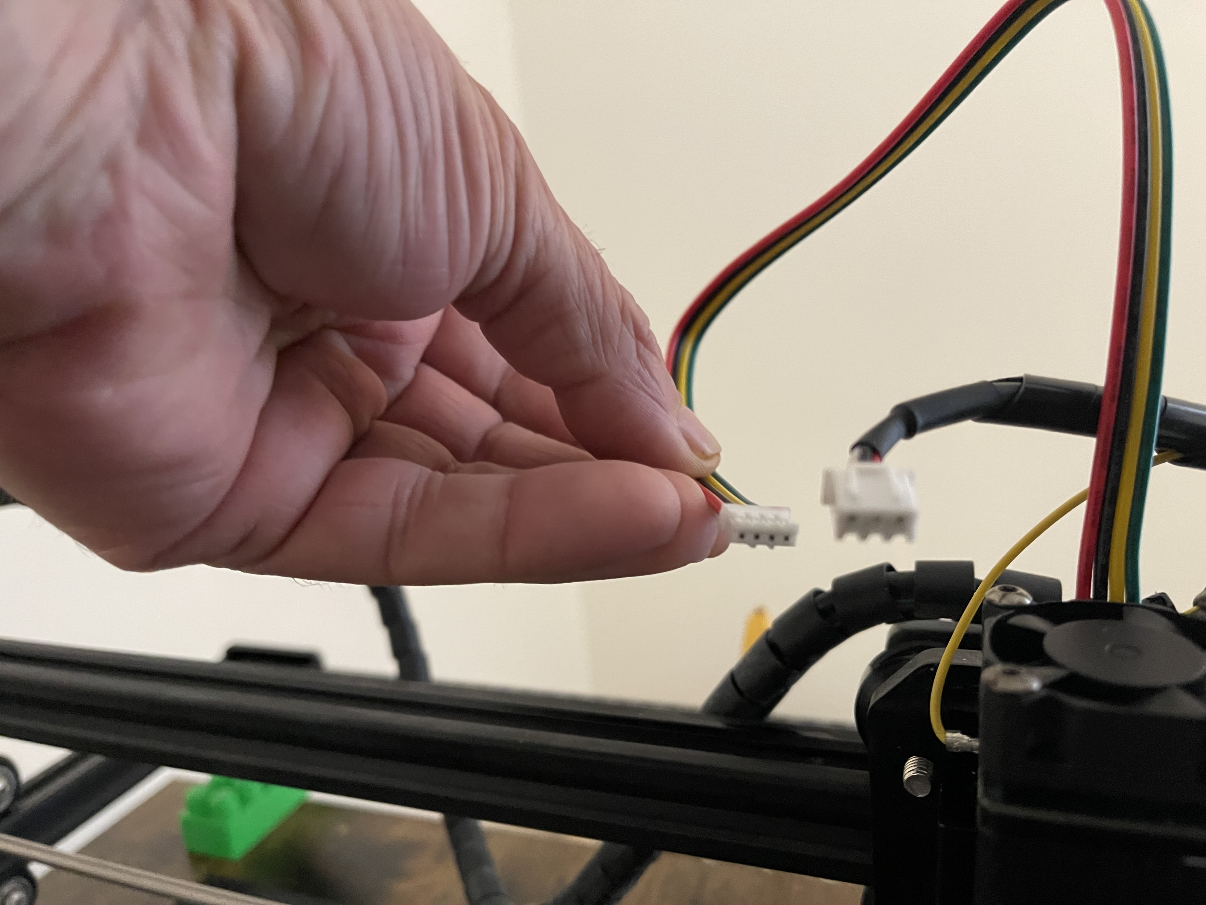

Dear sir I am hoping you may be able to assist me. I have a 5watt diode laser and trying to upgrade it to a 80watt NJE laser. Unfortunately I was told it was plug and play but that was not the case at all when it arrived and I attempted to install it on my Ortur Laser engraving machine
The current pin arrangement is 3 pin colours red, white, and black wires on the ORTUR MACHINE which is brand new. And the pin arrangement on the new 80 watt laser is 4 pin and colour of wiring is red,black,yellow, green.
I am not sure if i can purchase an adapter for this to properly connect the wires safely or if I have to strip the wires and connect the wires this way and need some ones help that is more knowledgeable in this area then I am so I don’t wreck my current machine and new laser:
I would appreciate anyone’s help that could help me please fix my laser machine so i can get it up and running thank you so much. I wanted to upgrade my laser from 5watt to 80watt so I could laser engrave glasses and travel mugs which I could not do with my 5watt.

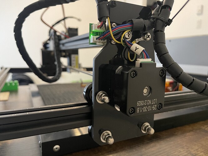

Current wires and back of ORTUR Laser machine with current board and wiring
You can find information on the NEJE wiki site for your model… but I suspect it’s similar to mine.
Your original laser has three pins, usually Ground, Power and TTL/PWM. The temperature is an output and isn’t required for anything except NEJE controllers.
Colors may be standardized on the Ortur machine, but generally they are not…
These three go to the corresponding pins on the new module. I’m sure you can find a pin out of the original laser module.
It sounds like a more powerful module. There is only so much power voltage avaliable here. I had to run a separate line through the drag chains and use a more powerful power supply for the laser…
