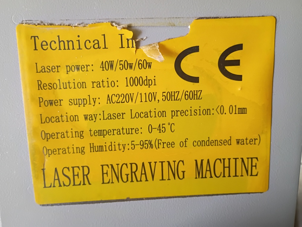

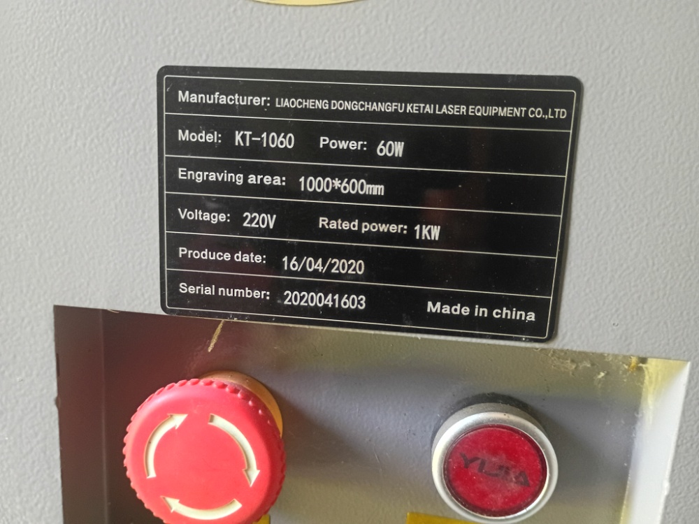

Hello, thanks for your response, and apologies for the late reply - had to visit the site and take photos. The current M2 board is dead - needs replacement - I need a board that supports LightBurn
You will need to find some documentation for the original board. Although it can be done by chasing the signals down to ensure you have it configured correctly.
Lots of companies make K40 upgrade boards that allow grbl to operate and Lightburn also.
:grinning_cat:
1000w in, 60w out? Is that for real?
Definately not Energy Star compliant!
