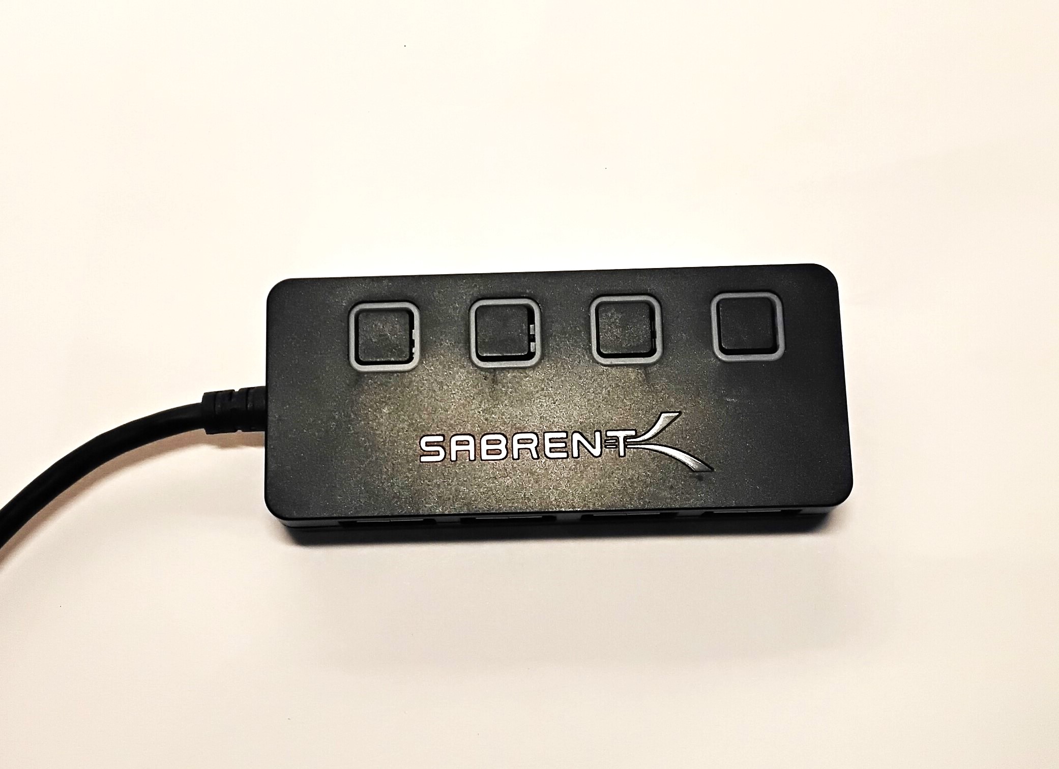

I was previously using a Sabrent 4-Port USB switch. It recently went bad on me where I thought the controller board had malfunctioned. Although the switch had buttons, even when it worked it would not fully disconnect the lasers. I would have to unplug the USB cable for one laser before plugging the other one in.
I finally decided to make my own 2-port USB switch instead of buying a replacement. The lasers are all USB 2.0, so I decided to go with only switching 4 wires. Switching all 8 for USB 3.0 would mean using an 8-pole 3-posotion rotary switch, if I could find one.
