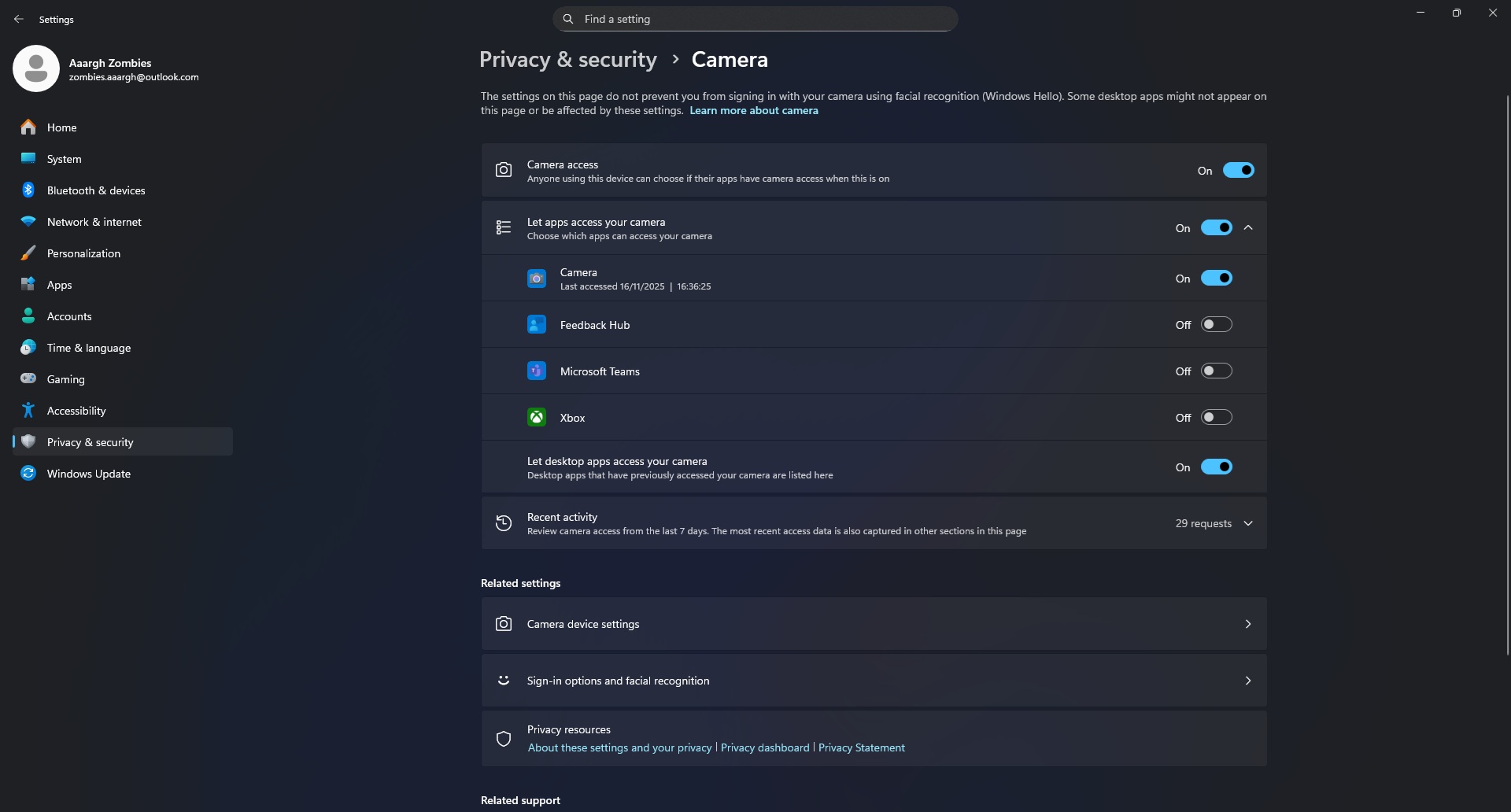

USB Web camera not visible to Lightburn in Windows 11
I’m using Lightburn 1.5.06 with Windows 11 and a generic white label USB web camera.
I “believe” that I have set up the privacy and permissions settings correctly. Other apps can see the camera and get a picture from it, but lightburn isn’t listed as being available and the camera section of lightburn has “none” written in it an won’t allow me to select any other options
Am I missing any settings anywere?
You might try to change the camera capture system in main settings. Sometimes this helps.
