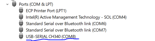

LAser USB
I apologize, was out of town and no longer able to edit the post. I can remake a new thread if desired. I am very sorry about this.
I enabled the DTR signal with no change.
Connected to LaserGRBL and I am able to control the head and move the laser with the move function in that screen.
In Laser window, there’s a pull-down for the serial port. You are currently selected on COM4, switch that to COM8. That should force a reconnect. If it does not right-click the Devices button in Laser window.
Don’t enable “DTR signal” if it’s not required but try it both ways if it doesn’t work with it disabled.
Seems to be working now with the move function however, the recommended settings for the parameters of the working size doesnt mesh with the actual device, also, it seems that the “x” axis is flipped ( I press left on the move screen and the device moves right). I have the control board at what I think should be the bottom because that is where the access point for the computer makes the most sense. I can upload a picture if required.
