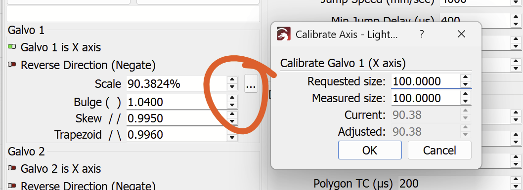

In the meantime, can you try recalibrating the Galvo Scale by doing this:
- Engrave a rectangle of 100x100mm
- Open the Device Settings and click on the three dots here:
- Measure the X axis of the square and enter the value in the “Measured size” field.
- Do the same for the Y axis.
- Engrave the same rectangle again and measure.
I’ve tried your solution a number of times and I can get pretty good results with a lot of iteration. The problem is that the test pattern outputs a grid that isn’t the correct size and then entering in the measured numbers makes a mess. I think something is amiss with the grid output code when it comes to the G2 Pro 50.
