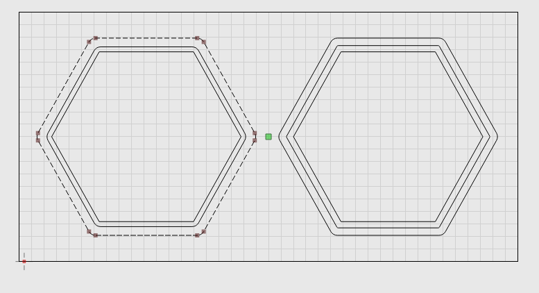

Endmill is at zero in the center of the stock but you can see that “show postion” is still in the lower corner and if I were to run this it would crash to endstop.
I also noticed that when I used postion goto panel I entered 0 for x and it moved to 2 not 0
Ok RC8 Center zero now works mostly.
However under menu “arrange→move machine to selection” it does not respect the zero position as set. This is also represented in the “last Postion” indicator on the screen still using the corner as zero reference.
While this is partially fixed it still not right on the display.
Setup Work piece with Center zero. Set Zero on machine, now it seems frame and cut correctly on the display the when zeroed the postion marker is off the lower left corner but the offset amount.
