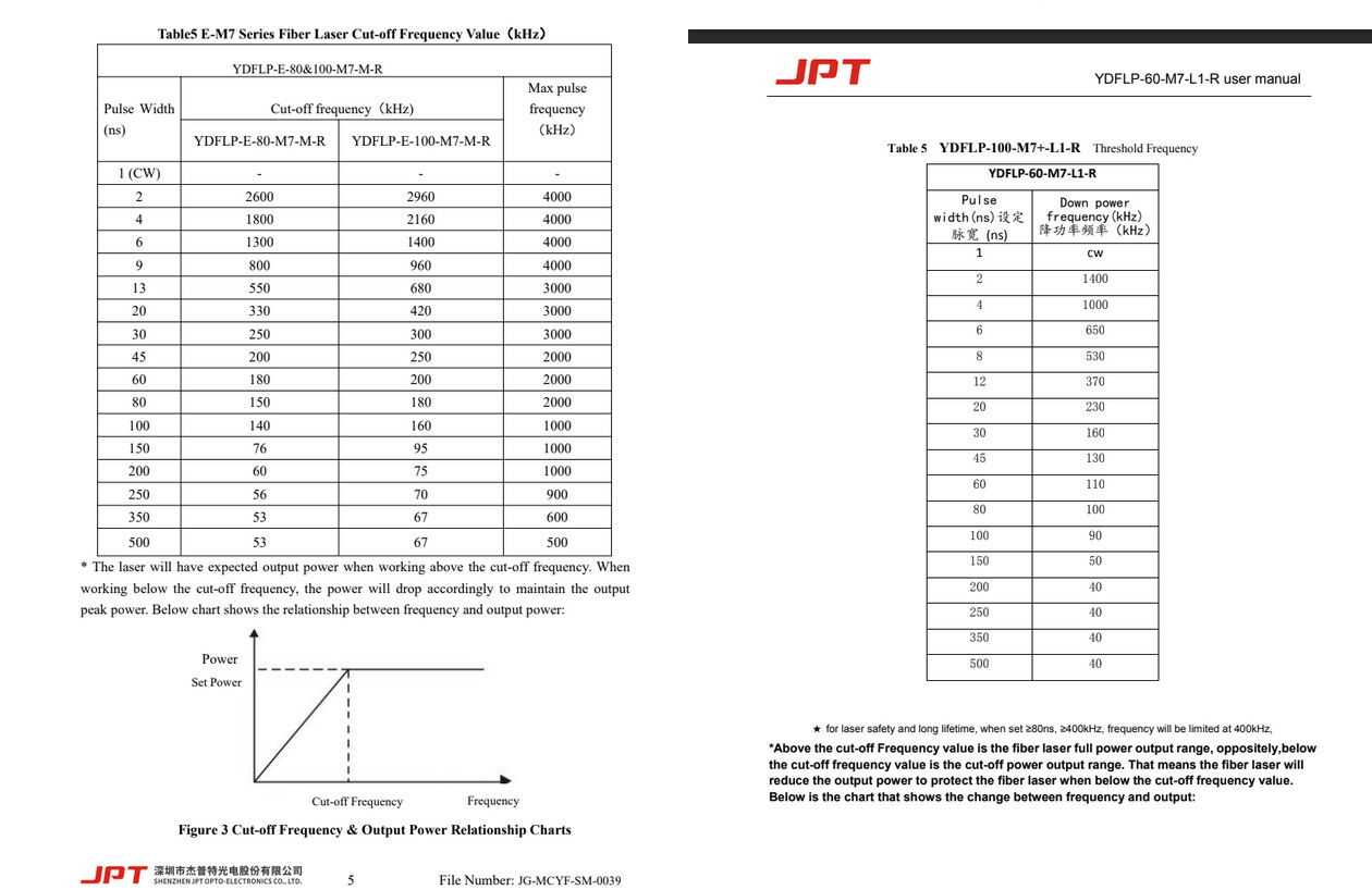

I believe there’s a lot more to consider when doing a lens selection. One of the issues, is the simply stated threshold value.
The problem I have, and I think I understand them, is that when you are doing a higher frequency you’re limited in q-pulse.
If you look at both of these, left for 80/100W models and the right which is my 60W, although similar the note is a bit different. The left states it wants to maintain pulse power
  • The laser will have expected output power when working above the cut-off frequency. When
    working below the cut-off frequency, the power will drop accordingly to maintain the output
    peak power.
The right 60W documents states
★ for laser safety and long lifetime, when set ≥80ns, ≥400kHz, frequency will be limited at 400kHz,
*Above the cut-off Frequency value is the fiber laser full power output range, oppositely,below
the cut-off frequency value is the cut-off power output range. That means the fiber laser will
reduce the output power to protect the fiber laser when below the cut-off frequency value.

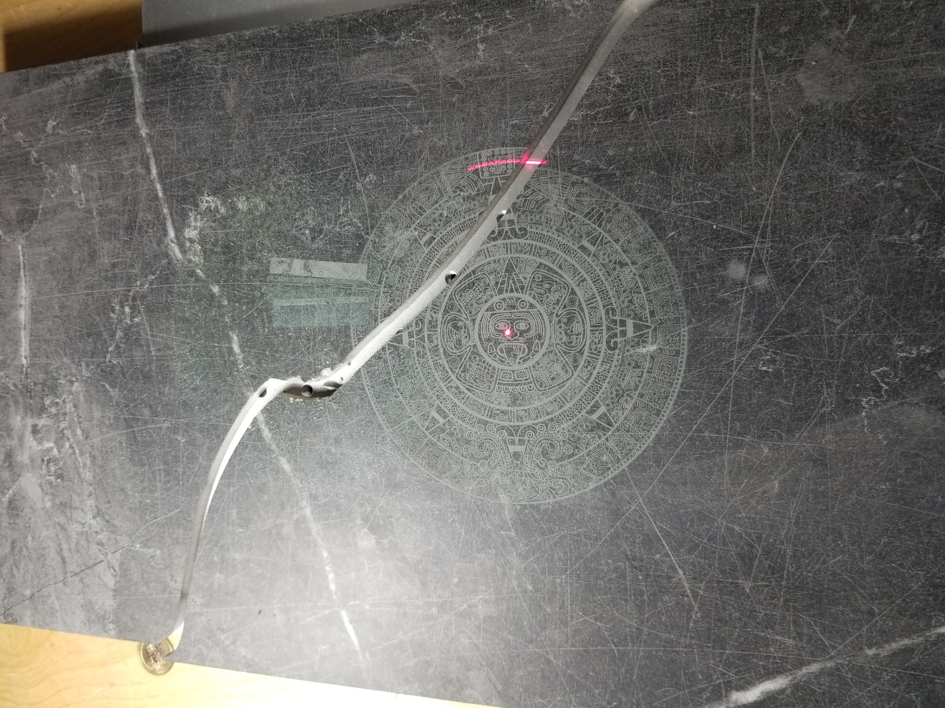

I have some 1’X2’, I think is the size, pieces of slate flooring. Attempted to lase a design on it. After it was done. I shut down the machine and went to dinner.
While at dinner we heard a loud pop and the slate flooring has busted, apparently from heat.
So I guess I don’t know what actual kind of information you need to make that decision… At some point, it’s trust me, why would I lie?

At the bottom of the threshold/cutoff frequency charts, the numbers simply show you reach the average power limits. All three charts are for lasers with a 1.5mJ maximum pulse energy.
40k pulses/second * 1.5 mJ/pulse = 60 J/s = 60 W
53k pulses/second * 1.5 mJ/pulse = 80 W
67k pulses/second * 1.5 mJ/pulse = 100 W
Below the cutoff frequency, per-pulse energy (not “power” as the Figure 3 labels it) decreases linearly because your average power is split over more pulses. You only have a certain average power being pumped into the fiber, and that’s just not enough to fully “fill the tank” between pulses. Taking the 60W as an example, if you asked for 80k pulses/second:
60W / 80k pulses/s = 60 J/s / 80k pulses/s = 0.75 mJ/pulse
Twice the cutoff frequency means you only have time to pump half the energy per pulse into the fiber.
So, what about shorter pulse widths and their higher frequencies before you start tapering off? Q-switched (non-MOPA) fiber lasers dump all the energy stored in the fiber every pulse, and I’ve seen that customarily shown as a fixed 200ns pulse width. For a MOPA fiber laser, on the other hand, you can control how much of the stored energy you dump. If you select a long enough pulse width, you’ll dump all the stored energy, just like a Q-switched fiber, but for shorter pulse widths, you’re basically closing the valve on the hose before the tank’s empty.
So, if you’re only dumping, say, half the energy before shutting off the pulse, you can get twice as many pulses before you run into the limit of not being able to pump enough energy fast enough. Looking at the charts and doing the math, it’s not quite as simply and obviously linear as the threshold (cutoff, “Down power”, whatever) frequencies, but I’m going to suggest that’s just rounding and the real world (efficiencies, etc.) doing the usual.
