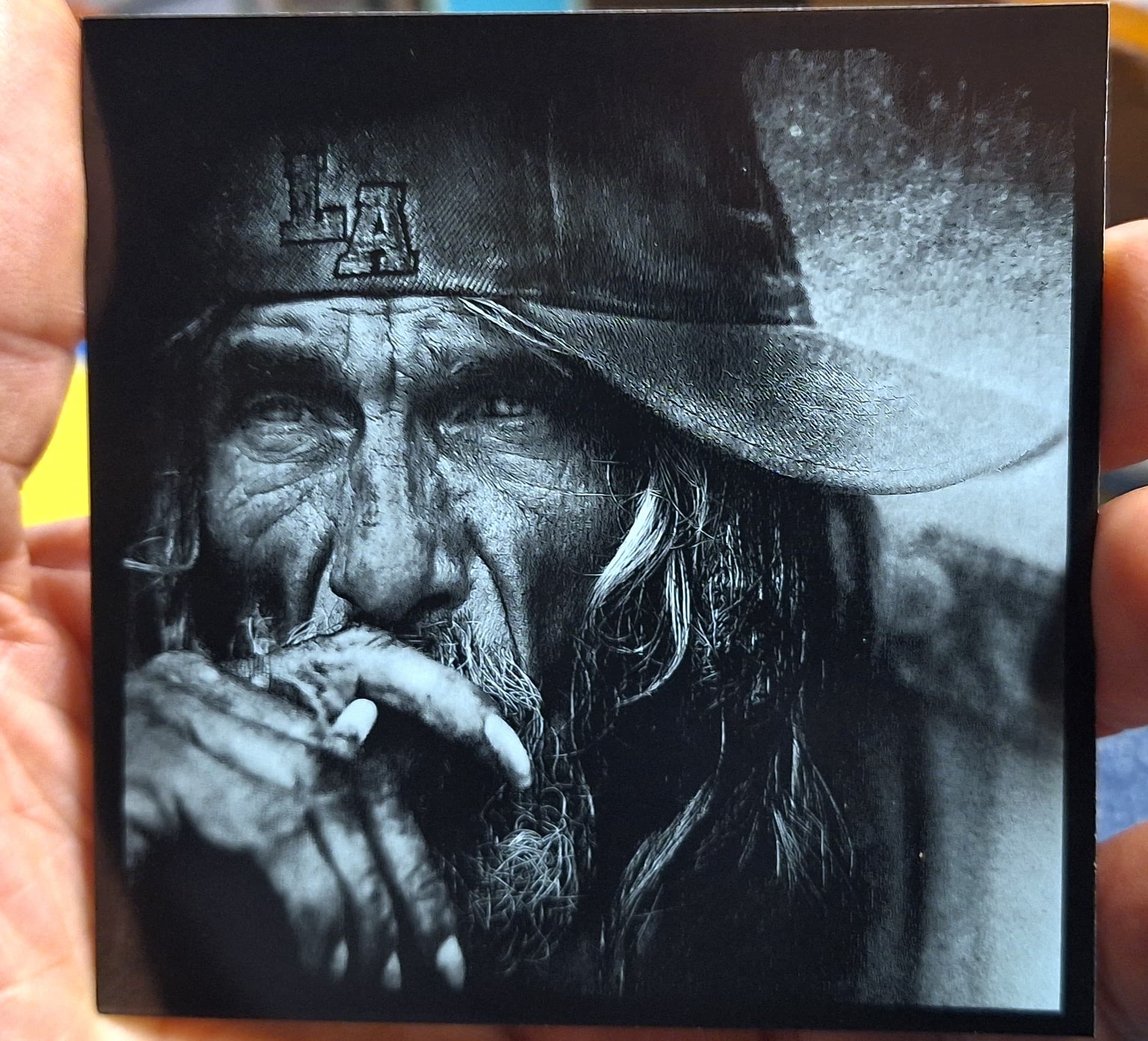

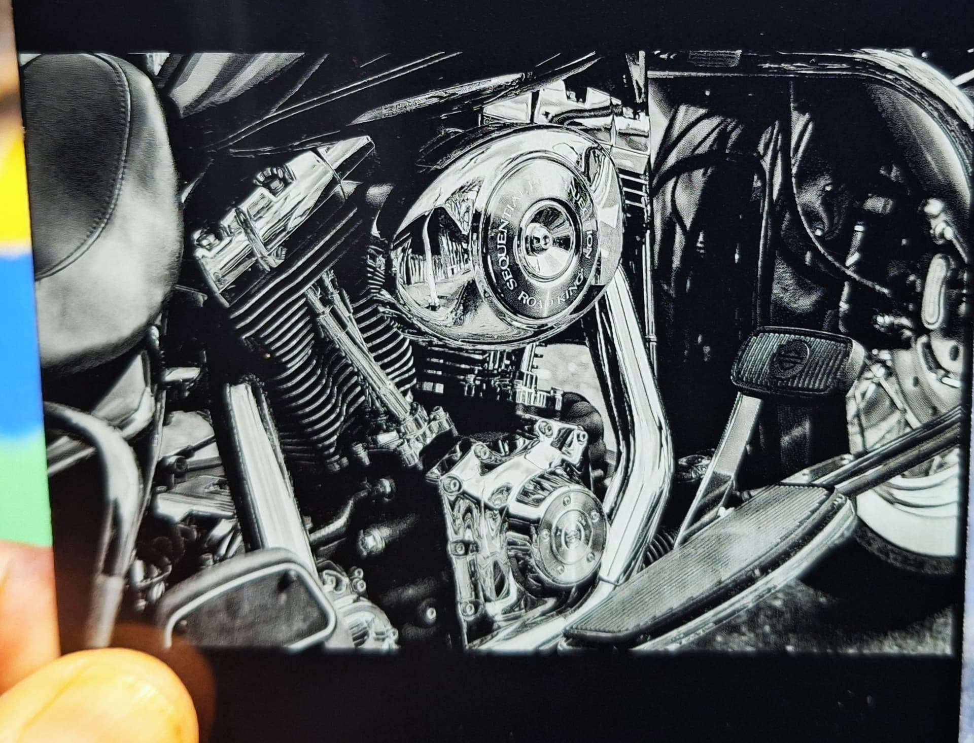

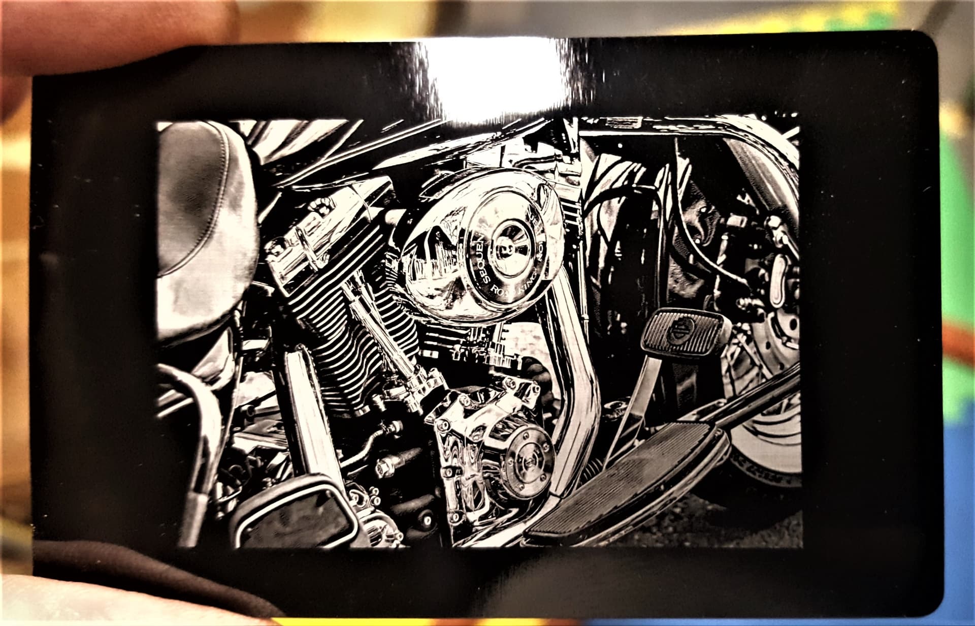

Using Cloudray Laser Engraved Dimmable Photo Paper
Using Cloudray Laser Engraved Dimmable Photo Paper From AliExpress
Amazing detail with this substrate
JPT 60 watt Mt MOPA 150 mm Lens
LB Stucki 518 DPI
2000/8%/120kHz/100 ns with 0.025 Dot Correction

Don’t post your pictures or we’ll all want a MOPA and cry until we buy it. :cry: :cry: :smiley:
Very nice as always.
@parsec >>>>I wont;t post my favourites then LOL
But in reality My Opt Lasers PLH3D-XT-50 5 watt Diode does as good or
better …BUT a lot slower
I have the same machine as he does and I still cry when I see them :exploding_head:
I think the fiber does a much better job… for a bit more coin
