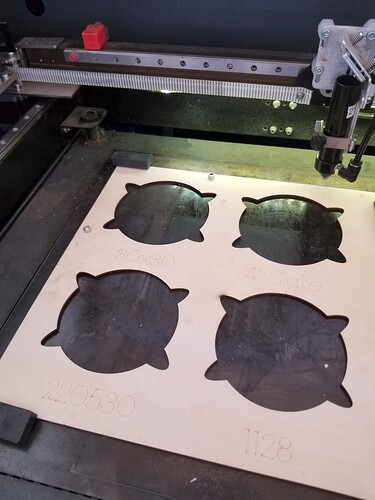

Hey guys/gals I was wondering if anyone has used the Roly jig table. I am thinking about getting it for engraving coasters and business cards. It looks pretty easy to set up but I was not sure how to use it in lightburn to know where to engrave the coasters the same every time. I’m pretty sure I am overlooking something so any help would be greatly appreciated.
You can make your own. I started with a sheet of steel that fit into my machine. This is for alignment.
I laser marked holes that were drilled by a drill press. This plate fits into my machine and I can cut out various jigs that I can address via the software…
How do you align that jig to your machine?
