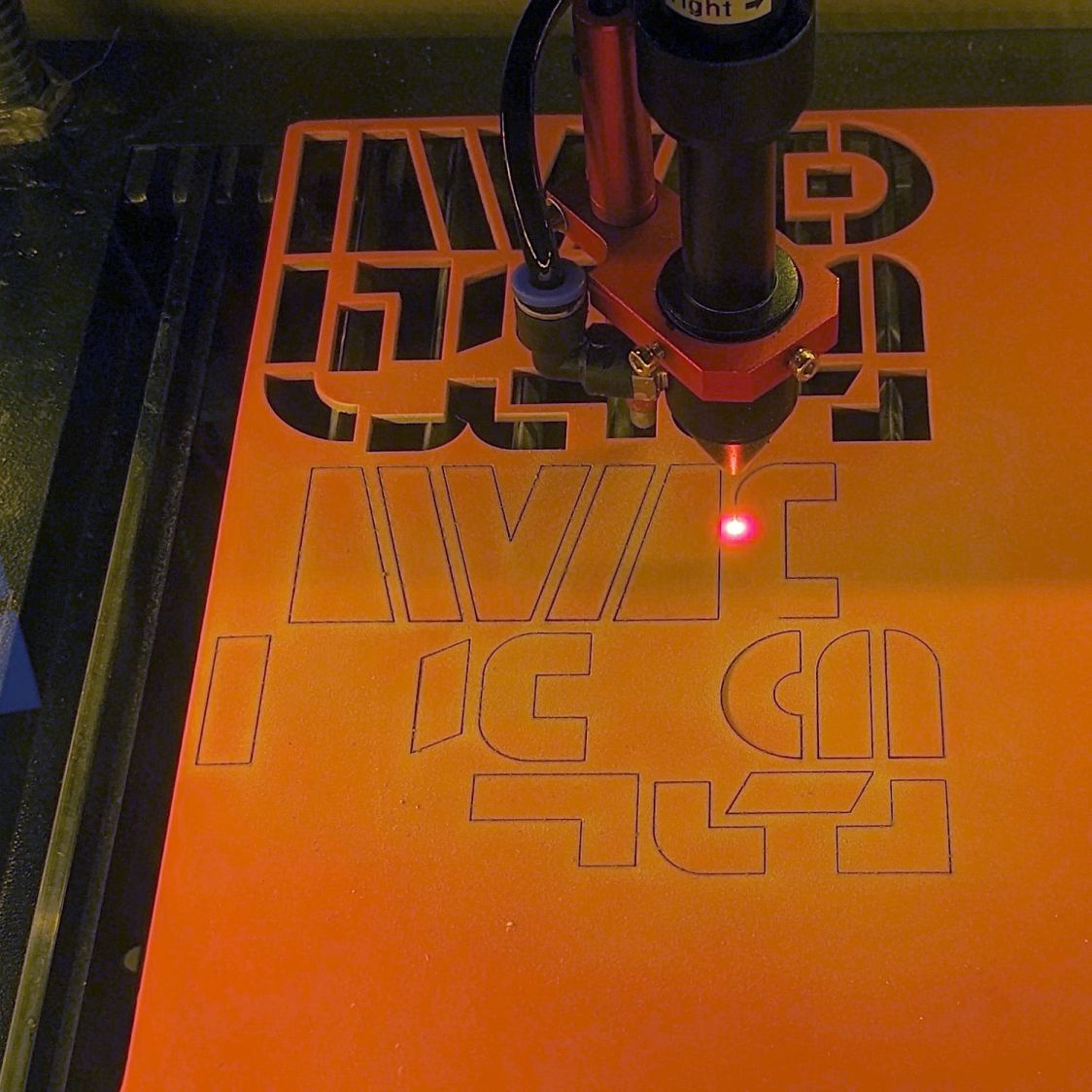

using lightburn to create paintblocks. does anyone do this and what materials do they use ? wood or rubber or whatever?
I believe your best bet is to use laser rubber, mirror your shapes and read the doc:
Thanks very much for that. I didnât know such a topic/post existed. I will do some reading now and see if I can find a supplier for rubber.
If itâs for something like a rubber stamp, these sheets from Amazon worked surprisingly well:
The cuts did not smell like a tire fire ⌠![]()
Thanks very much for this. I will have a look.

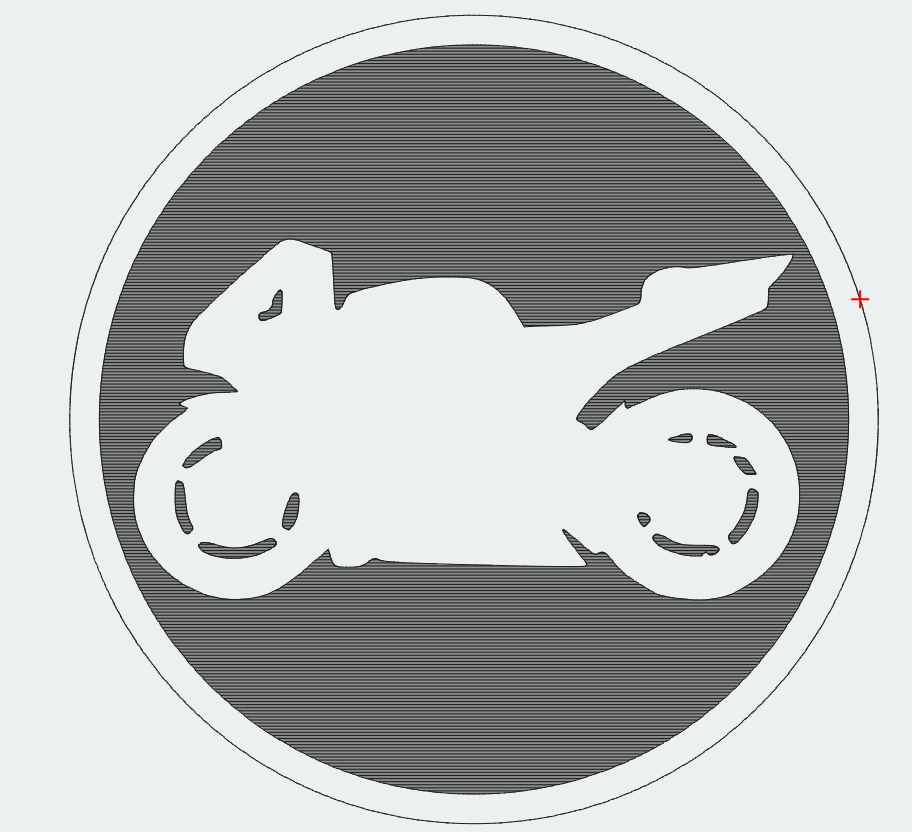

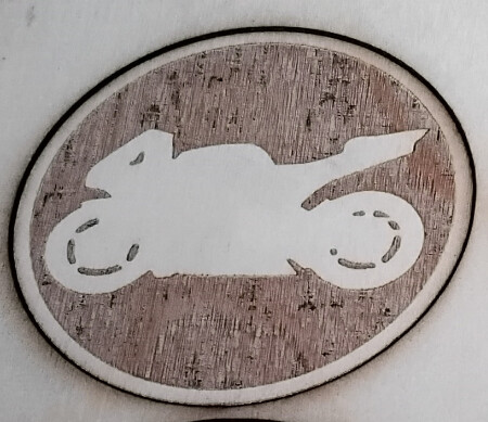

I couldnât resist having a look at this and it. When I click on âPreviewâ it looks like a motorcycle within a circle. very nice and would be what I like and want to do. however I think it is the reverse of what I want. I want the motorcycle and the outside ring to stand out and the background to be cut out. Any suggestions ?? Thanks from a very new newbie. There are quite a few things in this project that I donât understand will you be able/willing to help me please ?? Thanks again for the help.
The black zone in the preview is engraved and the black outline is cut. the motorcycle and the ring are positive. The brown you see in the example is âdepressedâ.
A doc to help you understand the FillMode:
And the preview window:

Engrave/cut the motorcycle, is a 55mm circle, and check the outcome.
