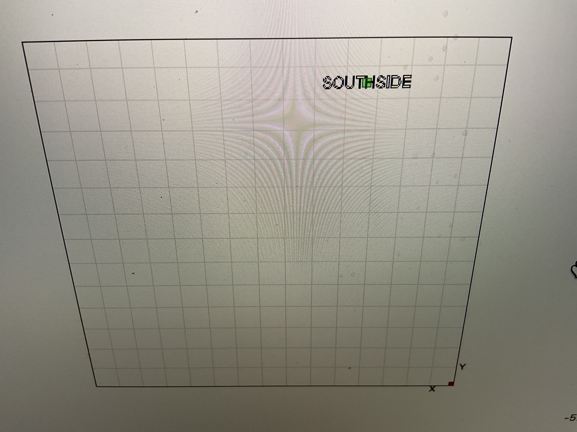

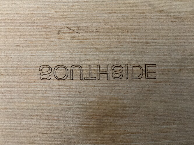

when i use numbers as part of what i am engraving some of the numbers show up backward or upside down.what am i doing wrong?
Upload two things so we can help:
  1. An image of the problem.
  2. The Lightburn file you used to create what you burned for the image taken.
Here is a copy of what I typed into Lightburn followed by what the engraver produced. Any suggestions as to what the fix is.
EdA

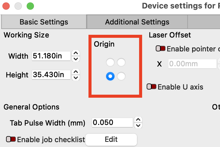

Go to your device settings and change your origin to the front left. Your origin is set incorrectly, it shouldn’t be in the front right. The red square in your screenshot tells me you have it set to the bottom right.
You may need to use mirror to correct your font after changing the origin…
