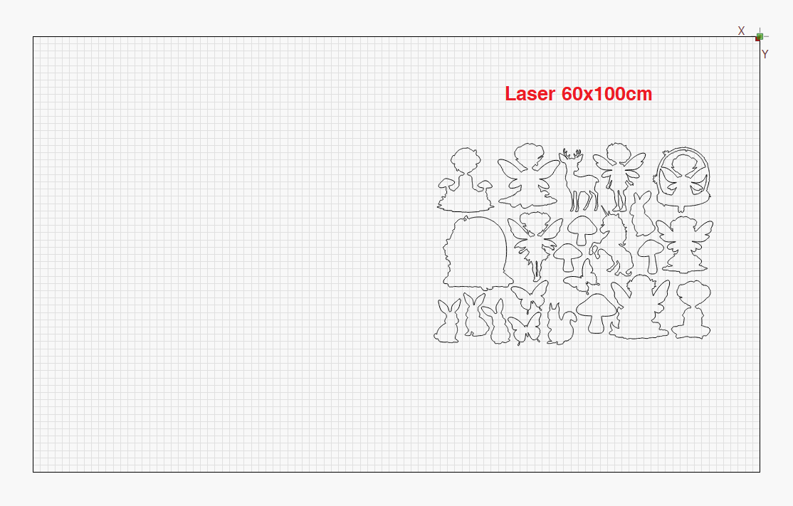

Hi,
We’ve been using our 60x100 cm CO₂ laser for quite some time now. Recently, we added a second laser to support production, but this one has a smaller working area of 40x60 cm.
Is there a way to adjust the zero (0) reference point for our second, smaller laser?
Currently, I have to manually rearrange our designs to fit the smaller bed size.
Ideally, I’d like to set a fixed offset for the smaller machine (e.g., X: -30 mm and Y: -80 mm), so I can adjust the reference point precisely. This would allow us to use the same design files for both lasers without constantly modifying them.
Both lasers use Ruida 644XS.
Thanks in advance!

Thanks for your help guys, however I’m still looking for a solution.
We use absolute coordinates for our programs and want to run the same file on two different laser bed sizes—the larger 60x100 cm and the smaller 40x60 cm. All of our designs fit within the smaller bed, so that’s not a problem.
The workflow is smooth once the file is set up for the large laser. But when we switch to the smaller machine, we have to manually rearrange the entire file to match the new origin, which is time-consuming.
What I’m looking for is a way to set a reference point offset after homing. If I could define, for example, an offset of X: -30 mm and Y: -80 mm on the smaller laser, I could align both machines to match the same coordinate system. That way, I wouldn’t need to edit the program each time—we could run the exact same file on both machines without adjustment.

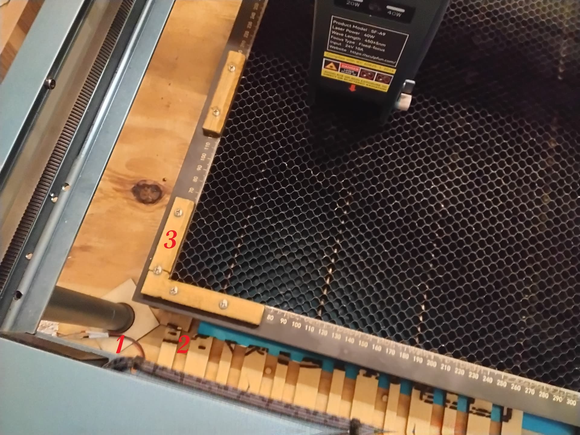

Here is my solution. Everything was made using the laser and scrap materials…
  1. Two squares with a hole glued to the bench to hold the feet of the laser frame. The holes are L-shaped for my S30 laser. This makes sure the laser is fixed in position.
  2. My honeycomb has 1"x2" feet glued to the frame to elevate it. The two each position locators glued to the bench are L-shaped to allow accurately positioning it, but can be slid back if needed.
  3. Plywood is aligned by the slightly raised frame above the honeycomb material. For items that have a curved edge, like some cutting boards, I added 5/16" bamboo stops to allow for proper positioning of items that do not have a well defined edge.
Everything I do is with Absolute Coords and I have even managed to re-burn some items with accuracy. This takes patience.
Surely you can work up something that allows you to obtain repeatable accurate positioning.
