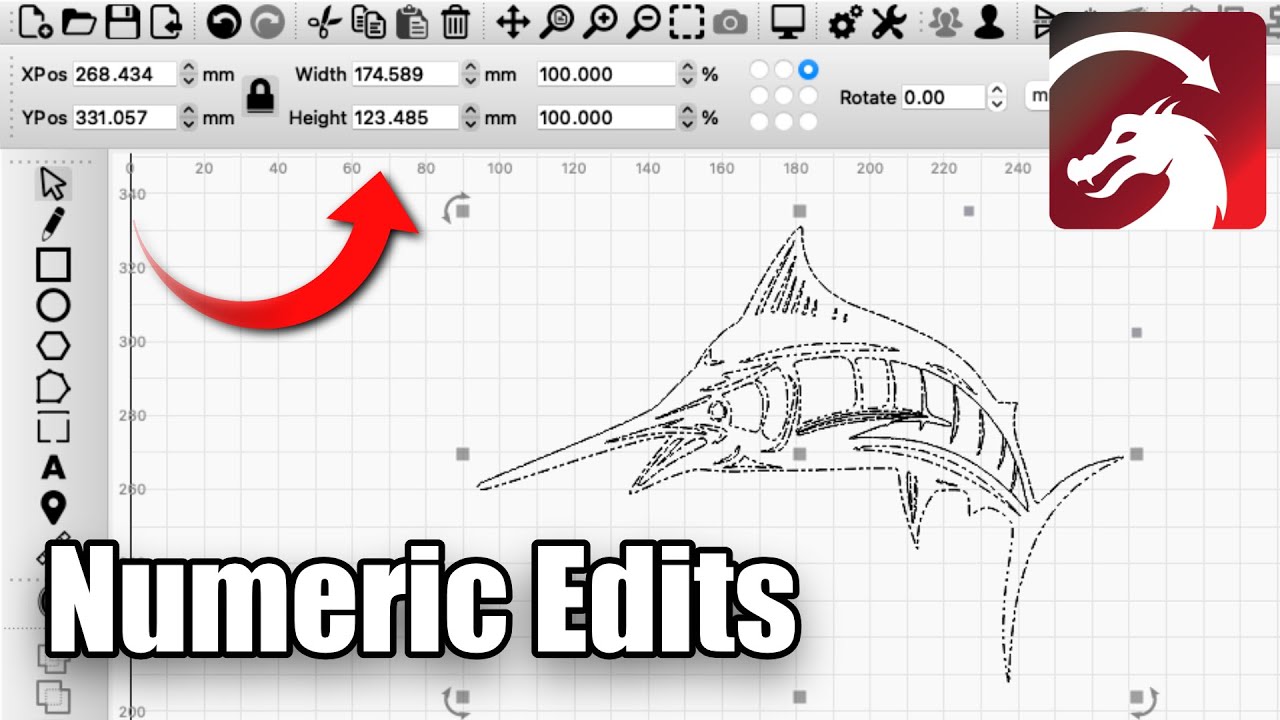

I think I already know how I did it but it was one by one. Basically, one by one, I centered (vertically and horizontally) the text in the box using that crosshair-like tool.
Then I selected the coordinate reference point at the center (center point of the set of nine points) 0:30 to 1:20 of the video:
After defining this point, I selected the text inside the box to see the Height and Width of the text in the dimensions fields.
Then (with the lock symbol unlocked) I selected the rectangle around the text and gave it the measurements of the text plus the margin I wanted. As the coordinate reference point is selected in the center, the rectangle will “shrink or stretch” to both sides and keep the text centered in the box.
It’s still a “one by one” solution, but it seems more efficient than drawing new boxes around the text for example.
Good idea with the numeric edits @Kuth . :slight_smile:
