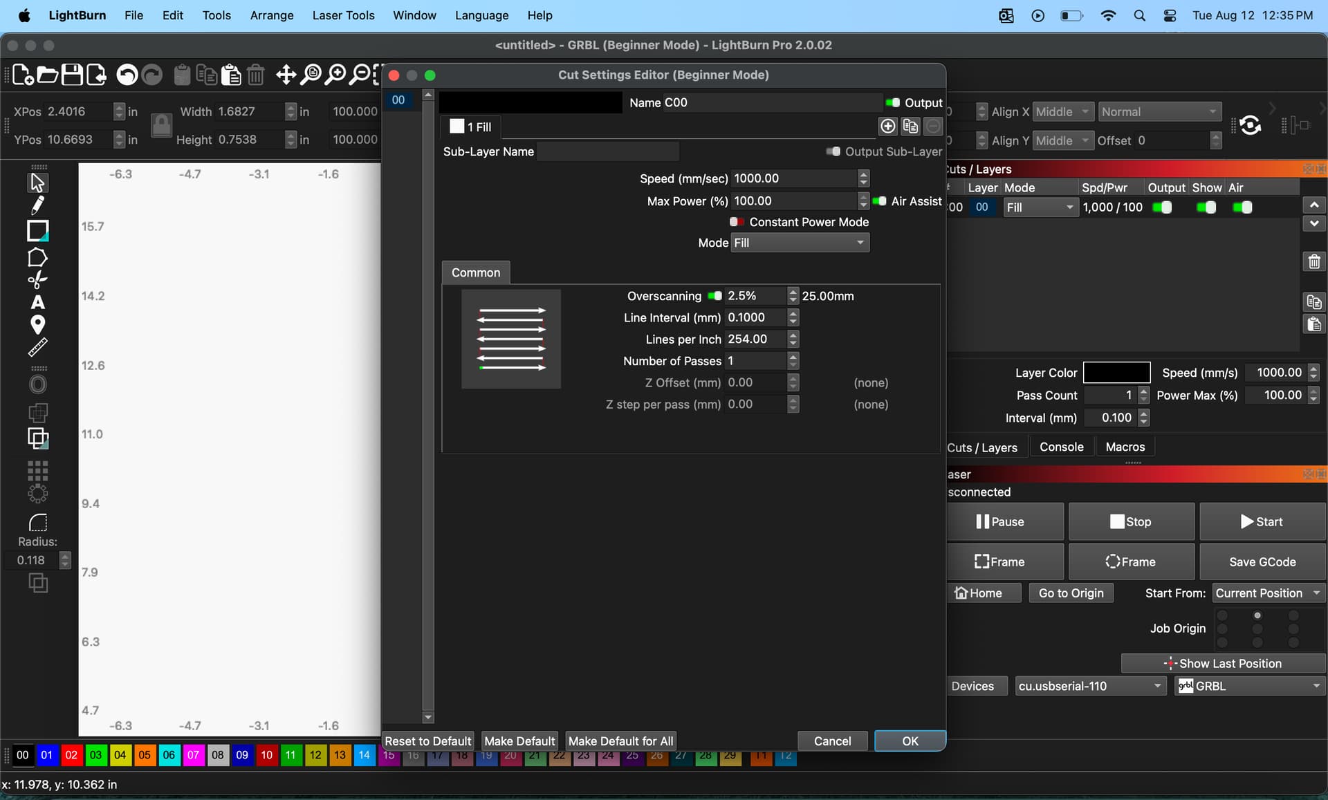

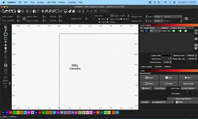

I’m trying to figure out how to use this software for my Vevor Laser. It is 20W, a model G3, and a 400mm x 400mm laser. I have attempted to follow some of the Lightburn tutorials, but when I attempt to do an engraving, it doesn’t burn, the blue laser light just goes side to side without engraving my materials. I’ve tried to adjust the speed and power max but it still doesn’t work. BTW this is the first time I’ve used a laser machine.

Click on your layer to open, so we can see your units
1000 mm/s is one meter per second. That is really fast. Try reducing your speed by a factor of 10 to start.
Start with 100 mm/s and see how that works.
