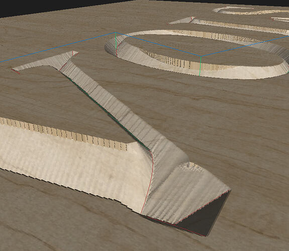

It looks like the output is being affected by the toolpath not being depth limited
So the 1/4" bit’s cutting edge is plunging below the top surface of the material
