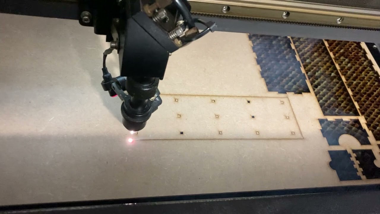

Cutting 1/8" HDF frequently results in rather violent popping that jars the work piece, often knocking it out of alignment. Initially I thought it was a heat reaction causing drastic warping from temperature changes. But it has since been confirmed to be actual rapid and rather violent ignition of fumes/smoke/gases accumulating under the work piece. The larger the work piece and closer to center, the stronger the affect.
I’ve read several postings online regarding acrylic causing this, which I’ve won’t go into, since I have no interest in working with any plastics. It frankly scares me to think of the potential health risks!
I have noticed on rare (so far) occasions that certain plywood laminates will produce a small amount of “popping” during cutting, but nothing comes close to the affect I’m experiencing with HDF.
I have cut up most of a 4x8 sheet’s worth of HDF thus far making various layout templates and even constructing an exhaust box for my fume extraction system with good success, but I have to make sure the work piece(s) are firmly held down, either with powerful magnets to the bed or simply holding them down by hand (no, I haven’t lost a digit or experienced radiation sickness or burns (yet).

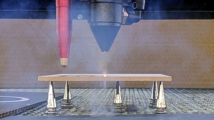

Although I haven’t cut HDF, my solution for flammable acrylic / plywood / MDF fumes is to not cut them on a honeycomb platform.
Instead, jack the material up on spikes to get good airflow underneath:
There may be a flame underneath the material, but it won’t turn into an explosion:
The honeycomb platform in my laser has steel grids, so the ring magnets on the punk spikes get a good grip. That won’t work on an aluminum honeycomb, but you can use MDF / HDF spikes:
The air enters along the front of the platform and I block off unused areas with cardboard, so the airflow pulls fumes across the top and bottom of the material toward the rear of the platform and down through the honeycomb.
Always keep a fire extinguisher near at hand!
Ednisley is correct, raising your work up off the bed will reduce flameups dramatically. I use sacrifical standoffs that I cut out of scrap 3mm - 4mm acrylic cutting standoff.lbrn2 (17.9 KB)

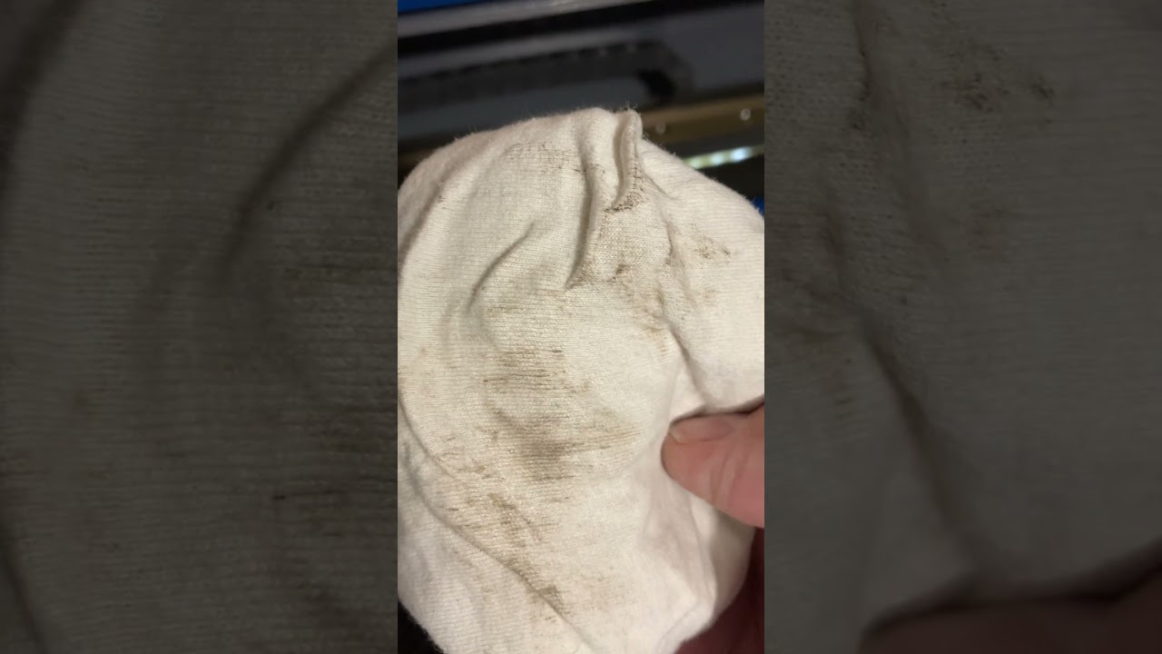

On a different subject… what doe you use to clean your steel grid to remove the build up carbon and sticky residue?
Three reasons I pitched my honeycomb bed…
  1. ruined the air flow
  2. difficult to clean
  3. number 1 cause of fire.
Replaced mine with a sheet of rolled steel. Drilled holes in it to align jigs. Wipes off relatively easy with a rag. Mine was also aluminum, another strike against it…
Have fun…
Haven’t had enough gunk accumulate on it to justify trying anything, but other folks have used anything from Simple Green to brake cleaner, so there’s plenty of room for experimentation.
Given that it’s steel, I’ll wait for a summer day when it can bask in the sun while drying.

I agree with Jack. The entire concept of a thick honeycomb is flawed. Those pockets of stagnant air in each cell are difficult to purge without significantly increasing air assist and providing ample open space and cross-flow below the grid.
… or increase extraction significantly. - …is the solution, or part of it.
I often read that people are not happy with their honeycomb and cannot recognize the arguments, or at least not them all.
I have in my machine the “knife” solution at the bottom and then my steel honeycomb. On the top of it can if I want to use it, a steel plate with approx. 20 mm distance from honeycomb.
98% of all my work on my CO2 laser is with honeycomb and at least it goes so good that I do not mount the steel plate as often. The main argument for using it this way is that it works here for me, with the ventilation and the compressed air through the nozzle I have. It is just easy and quick to orient material to 90 degrees with the help of the outer edge of the x and y frame and I do not have a fraction of the condensation that when I use the steel plate on the top of the bed (without extra raising the material to be processed)
If a template is used to fix items and it is located directly on a closed steel plate, the result is a big mess, the heat and the combustion gases hit the steel plate and condenses without the possibility of being sucked out.
