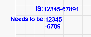

Working in Variable Text (I love it), photo is showing the IS; is how the text is in CSV, the Needs To Be: is the all the area I have to work in and requires the pulled in text to Wrap. Any ideas how this wrap can be accomplished in LightBurn, not in the CSV.

Split the text into 2 separate fields, in LightBurn use discrete fields for each row.
That sound great, but I an not following you.
He’s suggesting you break the long pieces into two columns in the CSV file. Anything that doesn’t require the 2nd field can just leave it blank, and anything that needs to wrap can break the element into two fields.
We don’t currently have a way to wrap text automatically.
