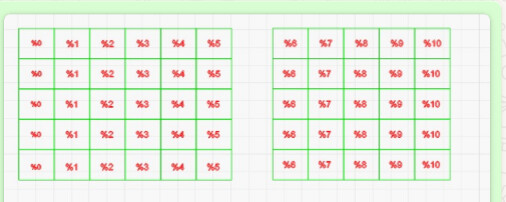

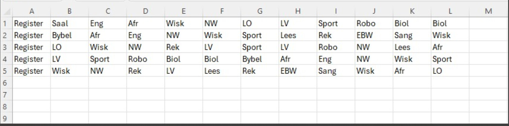

I am busy designing a school timetable and use variable text, everything is working except when I import the csv file from excel, only the first row repeats in all the other rows.
This is my template in lightburn
This is my excel spreadsheet
When I import the excel spread sheet, it repeats the first row in all the other rows.
How can I change it, or what do I have to do or change, to correct this?

That is working as designed. The %0-%10 is representing the 1st to the 11th field left to right. You have the same thing repeated 5 times vertically. if you use the “next” button, you will get then same thing, but with the 2nd line of your spreadsheet repeated 5 times vertically. Are you generating multiple different timetables? if so, you’d have to change the format of your spreadsheet to be 44 cells wide, with each row representing the 5 day timetable, and in lightburn, put 0-10 in the first row, 11-21 in the 2nd row etc etc.
If you want the entire spreadsheet output as it is you need to change the offset for each line. First line remains as 0, 2nd line 1, 3rd line 2, etc.
Yes, I realized that my offset was wrong, that’s why the first line repeat itself. My offset was 0 for the entire table. I changed that, and it is now working.
