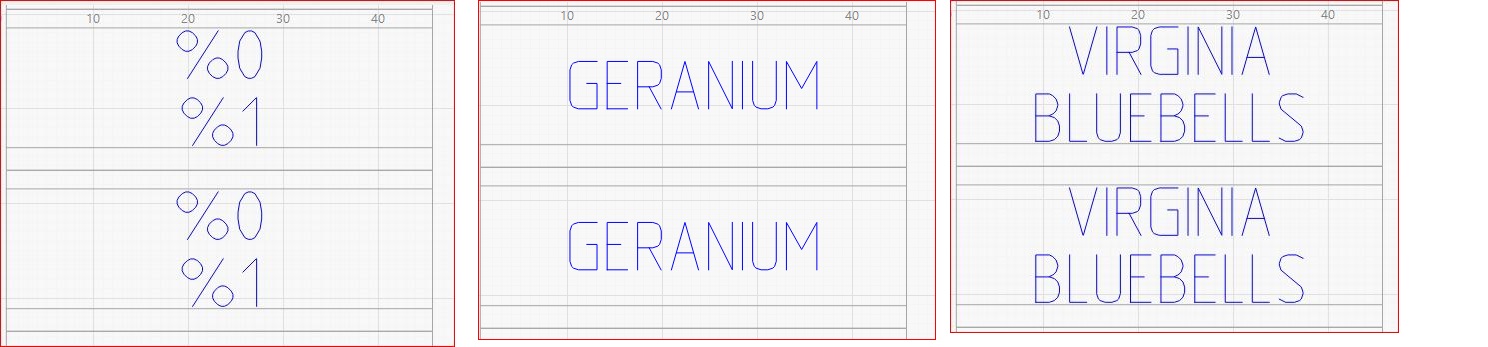

THANKS!!! after changing the Y align to middle for each text box which was just the 2 lines of text:
%0
%1
I am right where I want to be… curious - what issue were you thinking when you said not quite all the way!? Me, I think you nailed it!

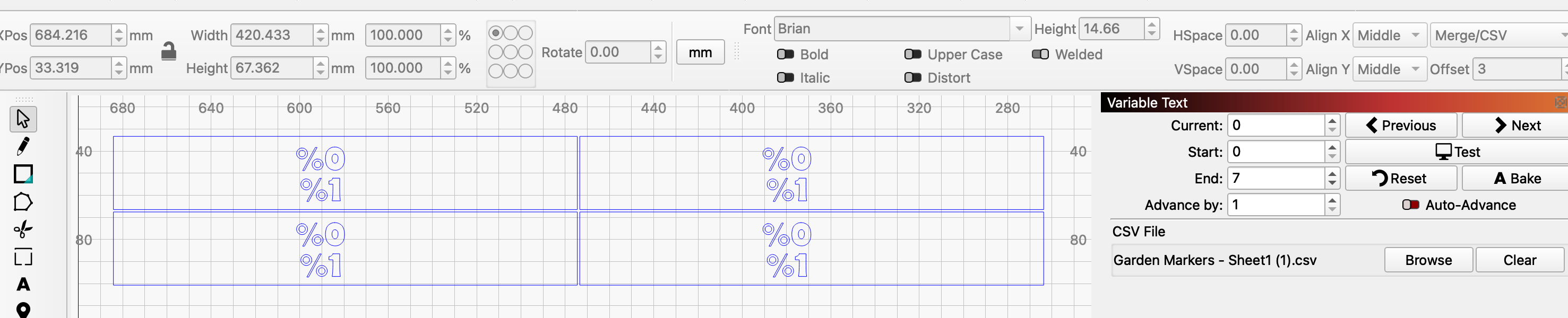

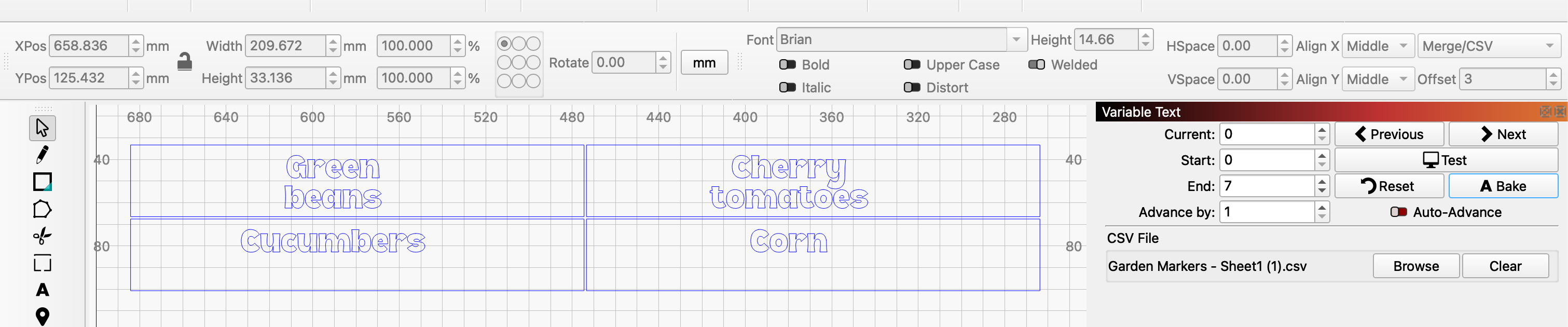

Not sure exactly how you got the single line text to align vertically centered. I did the same test and my single line text remains in the same location as the variable. I have the text set to middle, both horizontally and vertically. The top 2 have items in both fields and the bottom 2 are just single items.
This is my result. The single items remain in the location that the variable rests rather than centering vertically.
I would be very interested in seeing how you achieved this.

I think it might be Ednisley’s comment about enabling ‘ignore empty vars’ that you might have missed?
Here’s the file I am making - feel fee to roast my file : ) Spacing isn’t firm yet. And I’ll turn off layer 2 from engraving. I just did that layer 00 to help with spacing (before I found that Lightburn will create an array when you give it spacing between the text boxes : )
test sticks6.lbrn2 (670.3 KB)
I saw that the docs say:
Ignore Empty Vars : instructs LightBurn to remove newlines preceding empty Variable Text fields when aligning text.
Maybe when you were doing it, each line was it’s own text box?
