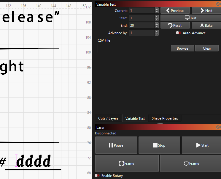

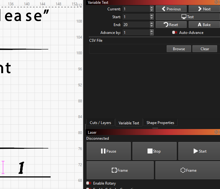

So I don’t know if I am doing something wrong but I have watched like 10 videos on Variable text and can not seem to get this to work. So customer wants it too look like this 0001 through 0023. So on Lightburns video they say if you want to lead with zeros put in dddd. But when i do this it changes it to just 1. See attached. Any help will be greatly appreciated.
Per the doc:
[…] pad the number with leading zeros 0
Add one leading zero to the string: 0dddd.
I needed to add 2 zeros but that worked thanks
