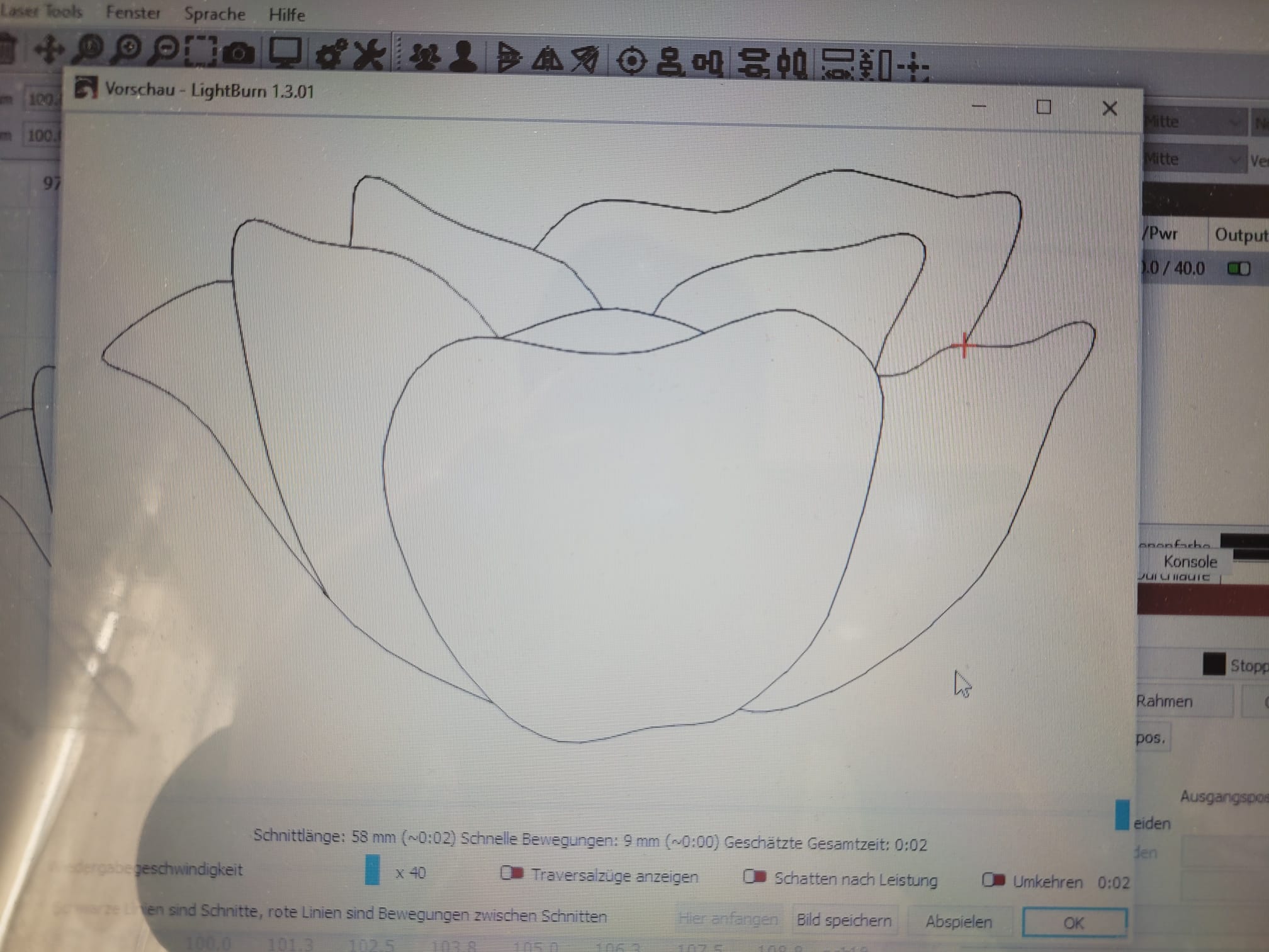

Hey,
I have an issue with my final laser result. The lines of an vector based project show an offset. What can I do?
Axis-Calibration has no influence on this…
Thanks
Johannes

… is it by several laps?
What show your preview window?
When you draw and engrave/cut a Ø100 mm circle, is it “properly” closed?
yes, the circle is closed.
I think I found the solution. My Frame was assembled not 100% rectangular. I retighten the screws and now I get better results.
Thanks
Johannes
That’s why I asked if the circle was closed.
